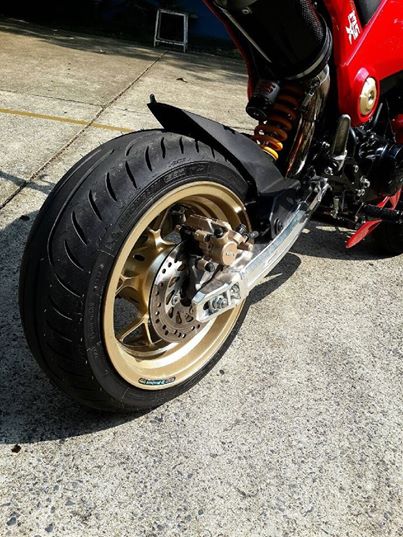

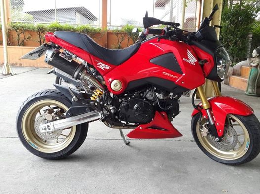

Look here from Motobot Racing, wishing Hard racing would carry these enkei 13" rims with the 3.5 inch front width and 5.5 inch width rear rims. Uses same stock crush hub and stock disc brake mounting and clears stock rear hugger.
Motobot racing will only sell the rims as a kit with tires but the shipping is the biggest down fall from overseas. $450-$420 shipping depending how fast you want those rims.
13" enkei front 3.5, back 5.5 starting from 925$
enkei13” wheels
front3.5
back5.5
withMichelin Power Pure tyres:
-120/70-13
-150/70-13
or
- 130/60-13
- 140/60-13
or
- 130/60-13
- 140/70-13
or
- 130/60-13
- 150/70-13
