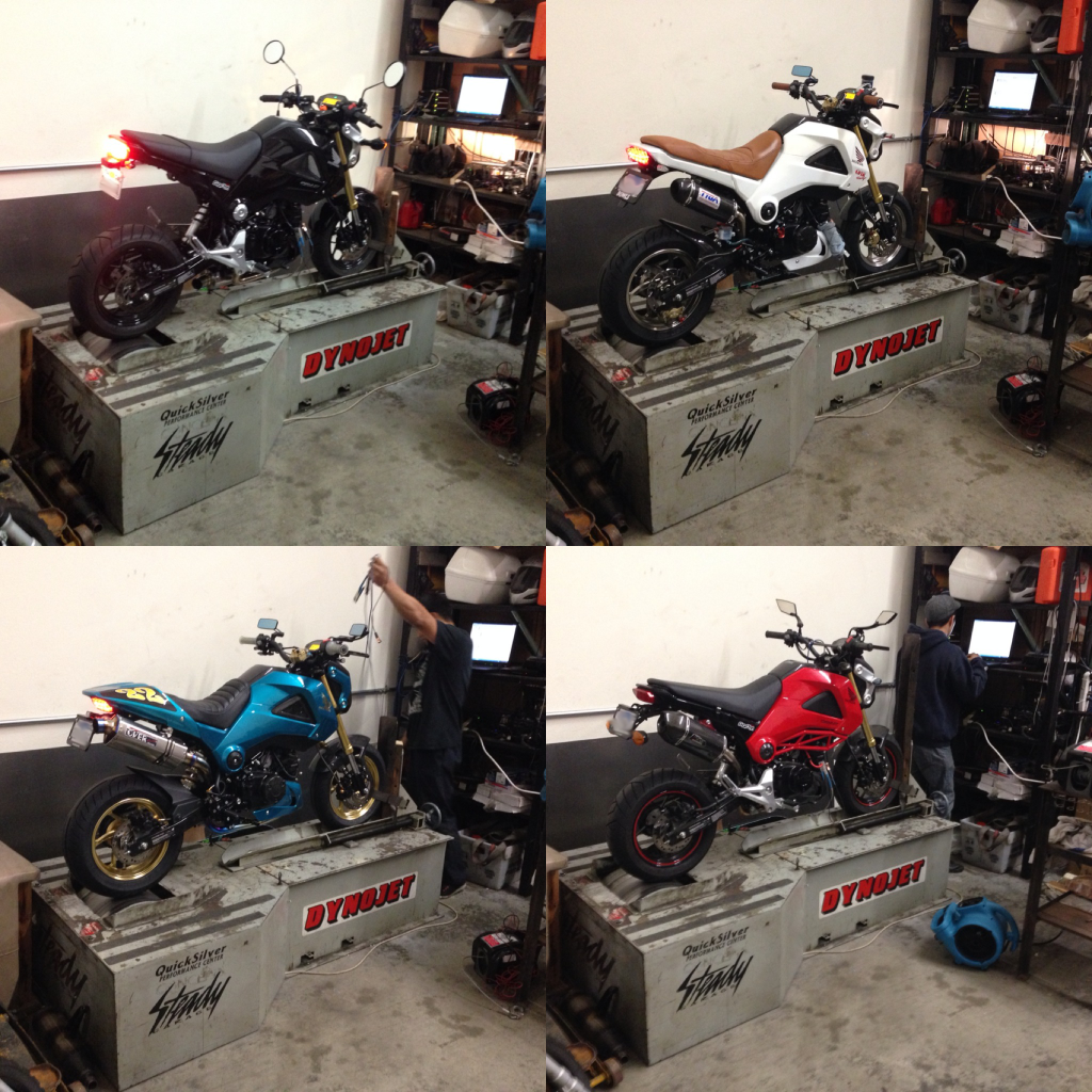

Dyno (In 3rd, Full throttle to Rev limiter starting @4k rpm)
Mods:
Yamamoto SUS Titanium Exhaust
(Link to my build thread if you wanna see pics installed. http://www.hondagrom.net/forums/27-grom-builds/3340-theorangebang.html
Chimera Intake w/ K&N Filter http://www.steadygarage.com/store/tw...125-air-intake
Stock Airbox w/ Airbox mod (328miles) :
1) 8.7 HP / 7.4 TQ
2) 8.8 HP / 7.55 TQ
3) 8.89 HP / 7.58 TQ
4) 8.83 HP / 7.56 TQ
5) 8.88 HP/ 7.57 TQ
Chimera Intake w/ No filter (340miles):
1) 9.38 HP / 7.4 TQ
2) 9.46 HP / 7.43 TQ
3) 9.6 HP / 7.4 TQ
4) 9.59 HP / 7.4 TQ
5) 9.62 HP / 7.4 TQ
Chimera Intake w/ K&N Filter (340miles):
1) 9.37 HP
2) 9.39 HP
Mods:
Yoshimura Full Race Exhaust
Stock Airbox w/ Airbox mod (2200miles) :
1) 9.44 HP / 6.92 TQ
2) 9.7 HP / 7.57 TQ
3) 9.72 HP / 7.57 TQ
4) 9.7 HP / 7.57 TQ
Chimera Intake w/ No filter (2200miles):
1) 10.52 HP / 7.88 TQ ( After seeing this, we booted his bike off the dyno)
Special thanks for Kevin and Jimmy @ SteadyGarage for letting us dyno pre/post intake.
Thanks to Slevin http://www.hondagrom.net/forums/27-grom-builds/1118-slevin-s-build.html for running the bike and GarryTheSnail http://www.hondagrom.net/forums/27-grom-builds/2779-garrythesnail-s-build.html for taking down the numbers

Wonder if the 2200 miles had anything to do with the better performance. Engine was probably not completely broken in at the 300 mile Mark. Was this same bike?
Thanks for the post!
2 different bikes. A couple of my friends and the guys at the shop speculate that it could be either the bike not being broken in yet, or that the yamamoto just has too many bends. Personally I have no idea, maybe some one with more knowledge can make it rain.
