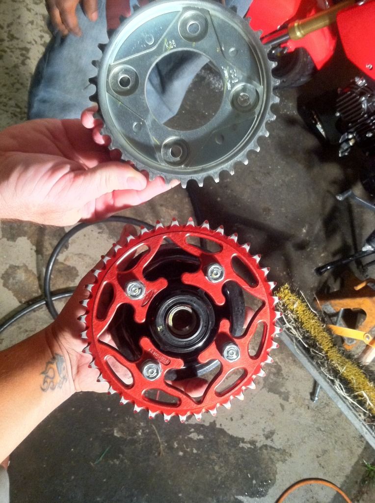

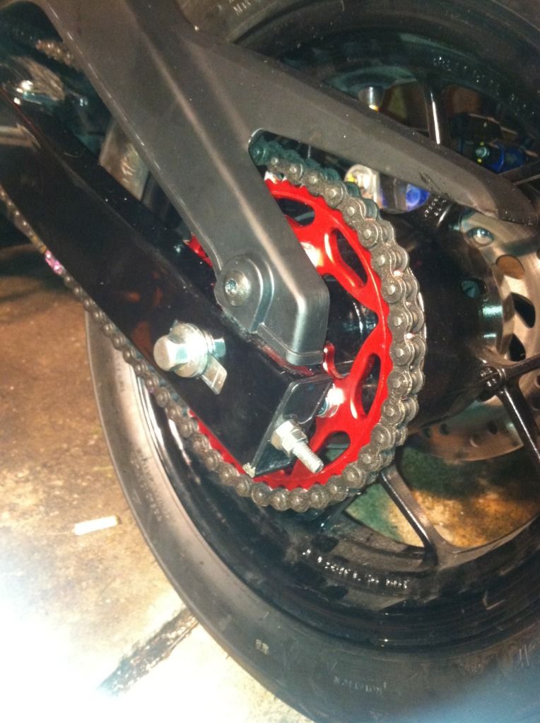

i forget, i think it was a sikk50 one.What brand of sprocket is that you put on there?
Vortex's hard coated sprocket is $50. Most brand name sprockets will be $40+.Thank you sir. I jus ordered one off ebay. 18 vs 50 for grom specific price gauging.
I just ordered this.Vortex's hard coated sprocket is $50. Most brand name sprockets will be $40+.
legit!I just ordered this.

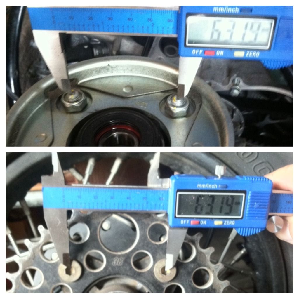

I think you should try it.I've been thinking about a 415 kit to take some weight off the drive train. Kind of like a 520 kit does on a Sportbike. Before you say that will not work or will break, my moriwaki 250 ran a 415 kit and it had 37hp.
you can order rear sprockets from my boy Ryan at HONDA CRF 50 XR 50 PARTS i'm asking him to see if he can manufacture them without the countersunk hole for the Grom
