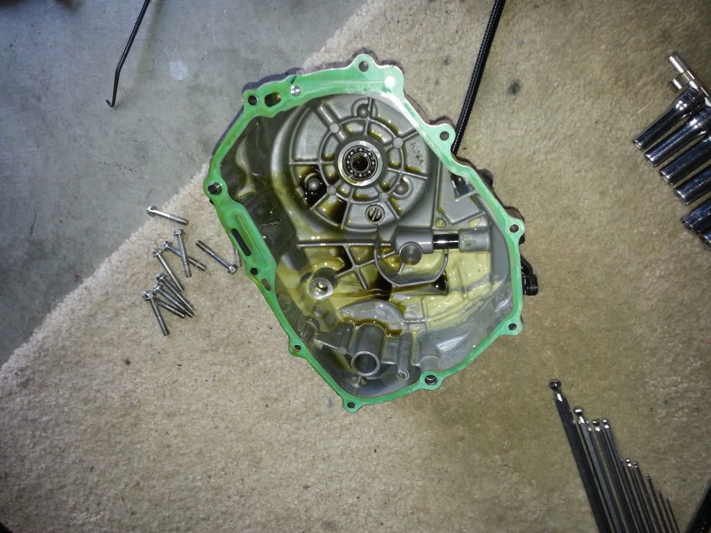

here is my engine case, its far worst then your milky oil, i have foam coming out of the filler threads, yes all the way up to the threaded portion of the dipstick.
my commute to work is like 1/2 mile, i try to let my grom warm up 5+ mins before i ride it in the AM, the engine case is still cold when i get to work sometimes, partially due to 20-40degree weather in the AM.
If you have foam in a water cooled motor, you got other issues.

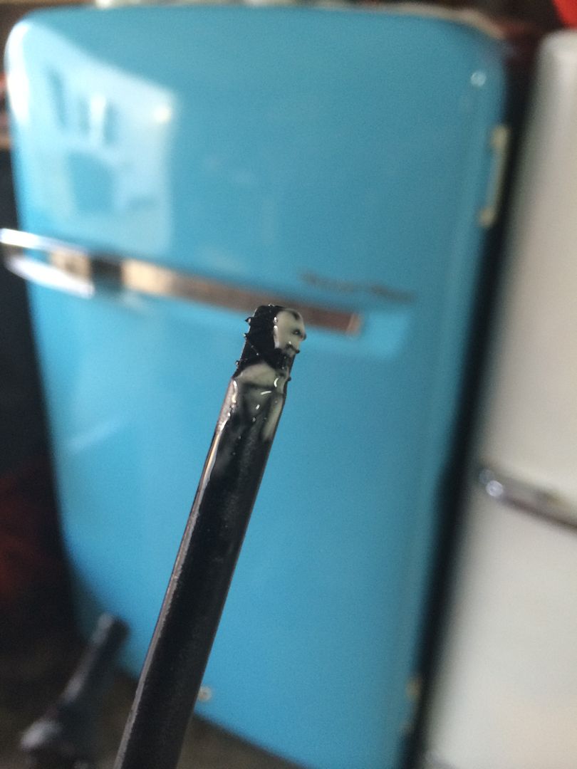

Had a huge problem with this as well.
Go on a long ride and get it as hot as possible. Then when you get home and park it, vent the dipstick for a bit.
I did this a couple times followed by an oil change. It seemed to all drip down into my oil which I then removed. Haven't had a problem since, although ambient temps have raised since spring is here.
