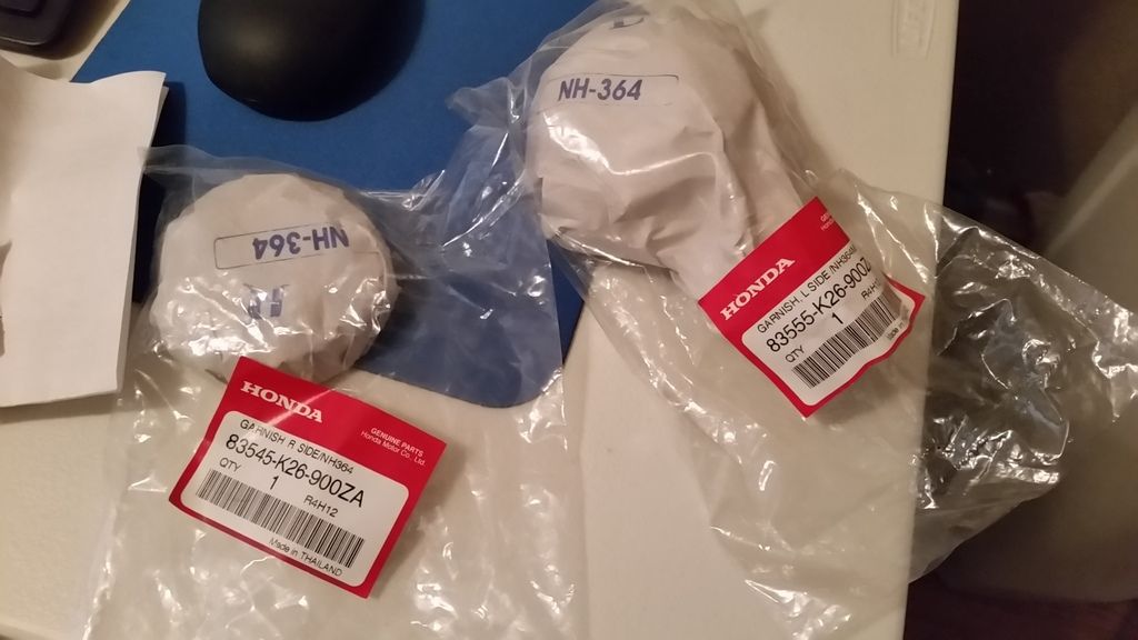

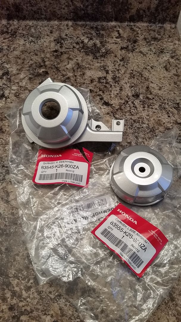

-Honda OEM silver side covers
-Honda OEM silver emblems

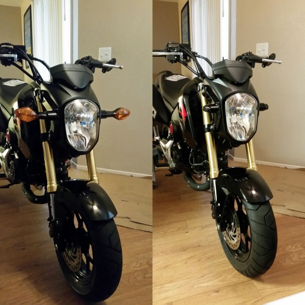

Shrek ear turn signals had to go. Picked up some smoked ones from HardRacing since my bike is black, figured it would flow well.
A lot cleaner (Don't know why some pictures are sideways but made a Photobucket so I should have fixed most of them)

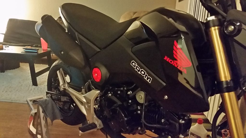

I wish I still lived by my old vinyl shop cause I would have matte black ones in a heartbeat. But settled for silver until I can find a decent vinyl place.

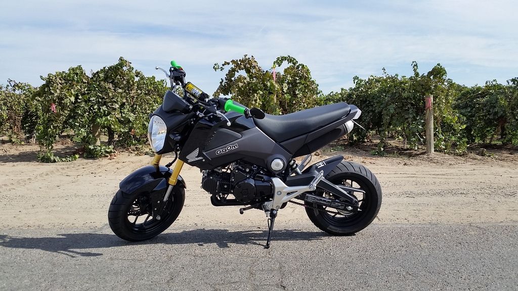

lowered the placement cause I feel it looks funny and up too high. (GROM sticker will be moved to the tail section later)

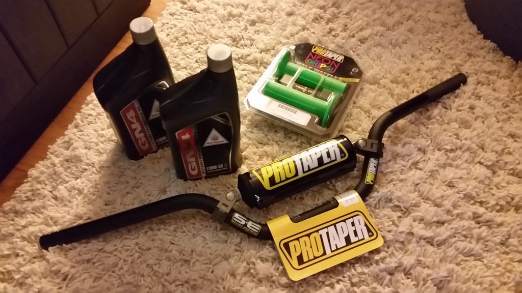

When I went to grab some oil from my dealer, I walked through the parts section and these guys were just laying there so I had to scoop em. Pro Taper Honda Minis since I didn't want to go too low. grips were just for fun :)

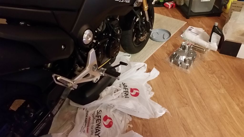

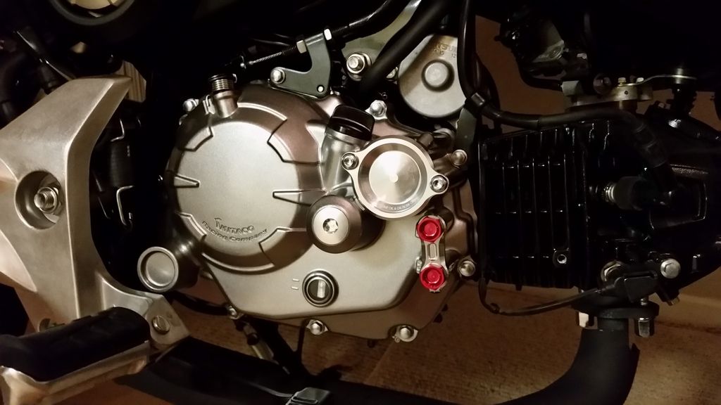

So I ended up doing this with the flywheel removal tool (got mine from Steady Garage for 18 bucks). I did not buy the flywheel holder as I just used a C-clamp to hold it in place to break the nut loose.
I didn't use the C-clamp at first thought I would try the hammer method first with a flat head and got negative results. C-clamp got it loose and bolted the new goodies on. (That actuator took me a minute though, until I saw how it went back in and was like AHHH soo simple.)
waiting for another day off to try it out... but xmas is going to set me back a bit on other mods :l

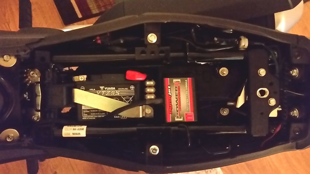

So next I wanted to get an oil cooler and temp gauge cause I would like to see what type of Temps the bike is running at. Don't like that dinky 3 row right off the header that does not seem like it would really do much. I was almost going to mount it top right side panel area until I came across the frame mount and 5 row oil cooler. (but would need a an aftermarket air filter to get rid of the box, and plus I want an exhaust I figured some fuel management should be first). After doing some research and the build that I'm currently going, I feel the PCV is the route for me. Plug n Play and was able to install it in about 20 minutes. I've been looking into programming this thing a little further once I read up on some fuel mapping.
At first I had the PCV next to the ECU but felt the seat was hitting it a bit. So rerouted the wire and trimed the inside square next to the battery (felt it would have less heat as well up there)

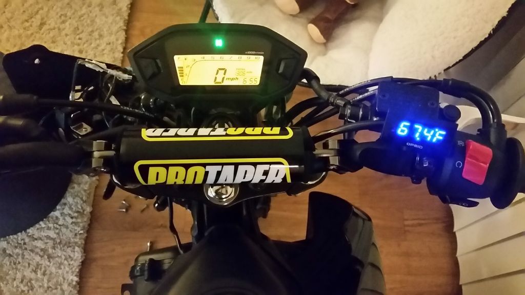

Have not updated this in a while so I figured I would add some of the stuff I've added. Finally got my OPMID temp gauge and like it a lot. (wish I got it sooner), an oil cooler is now on my list.

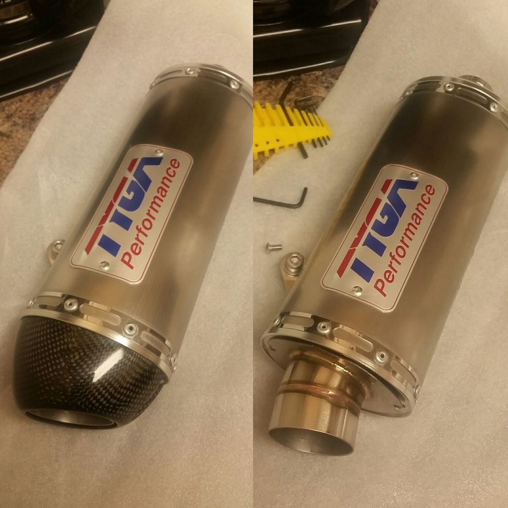

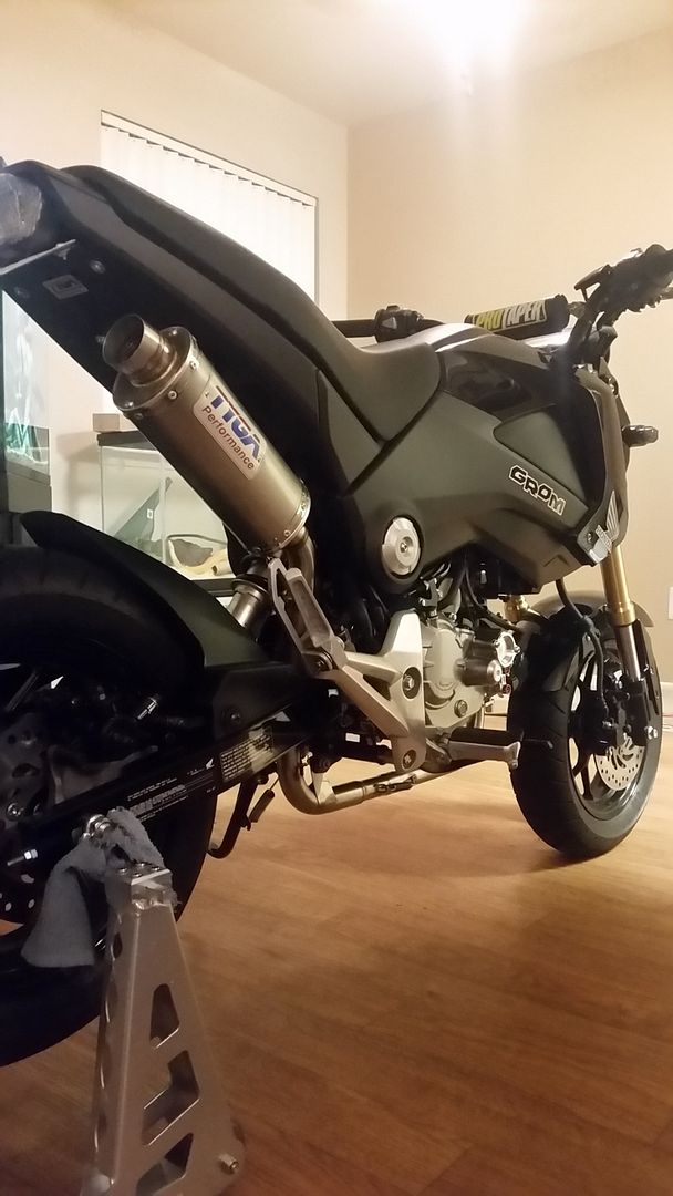

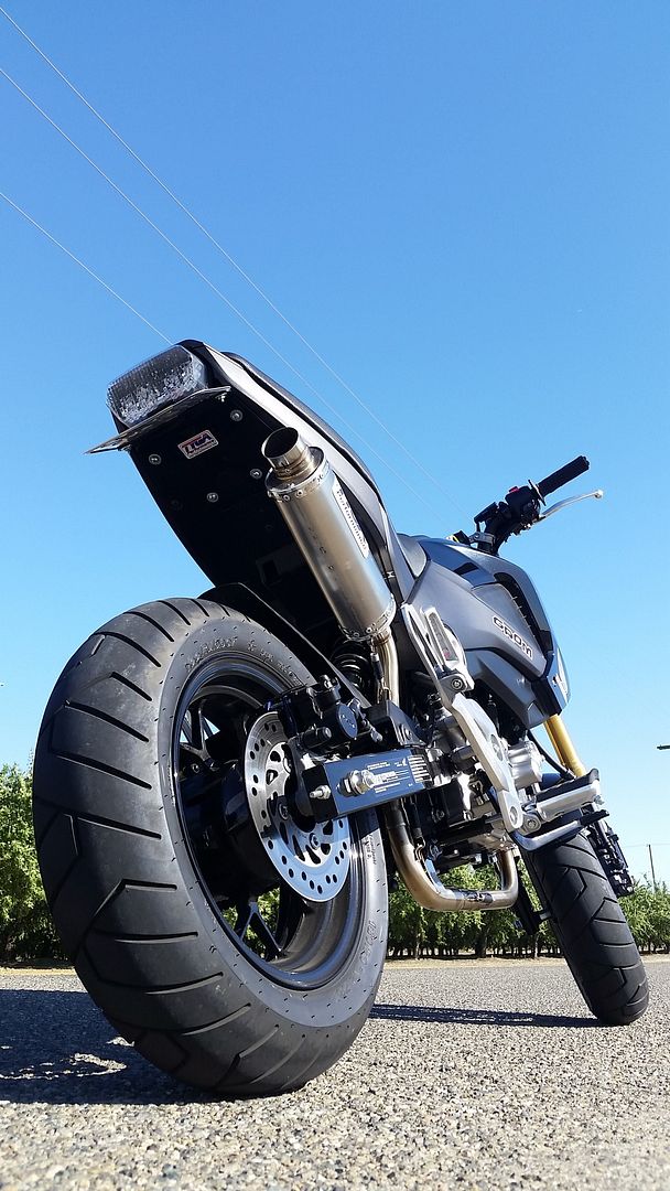

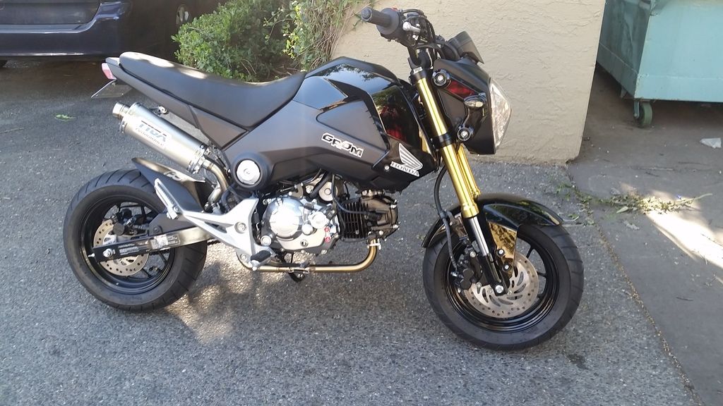

After months of YouTube vids and threads reading about different exhausts, I decided to go with the TYGA full exhaust and it sounds really throaty for a little single cylinder, I like it a lot! I personally like it with the end cap removed and will cruising around like this for a bit. Makes the exhaust way more cleaner and a more industrial look. (and I did re tighten the allen bolts, just not in this pic lol)
More will come once I can get a chance to update some more...

Oh yea, had it about 2ish, 3 months now and it's nice... it's more packed now so it has a good bubble to it. My buddy has the MNNTHBX and it looks and sounds nice as well, but his is a lot louder. Makes mine sound like just a slip on or something lol.
