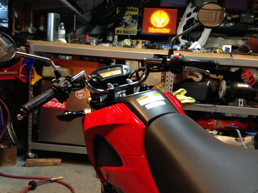

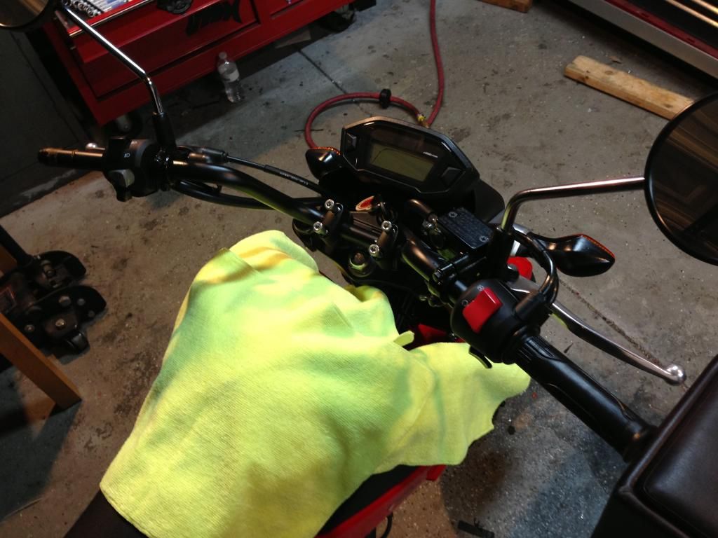

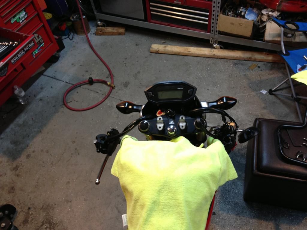

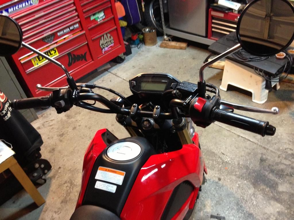

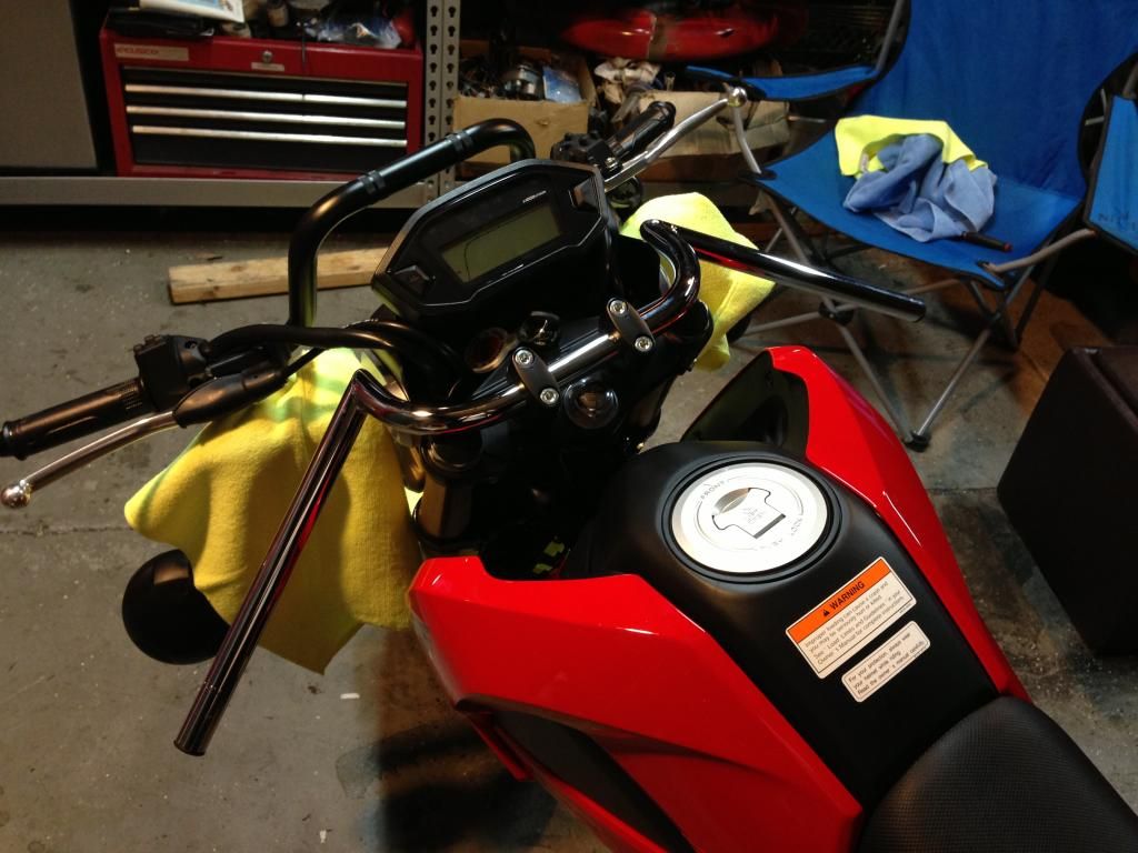

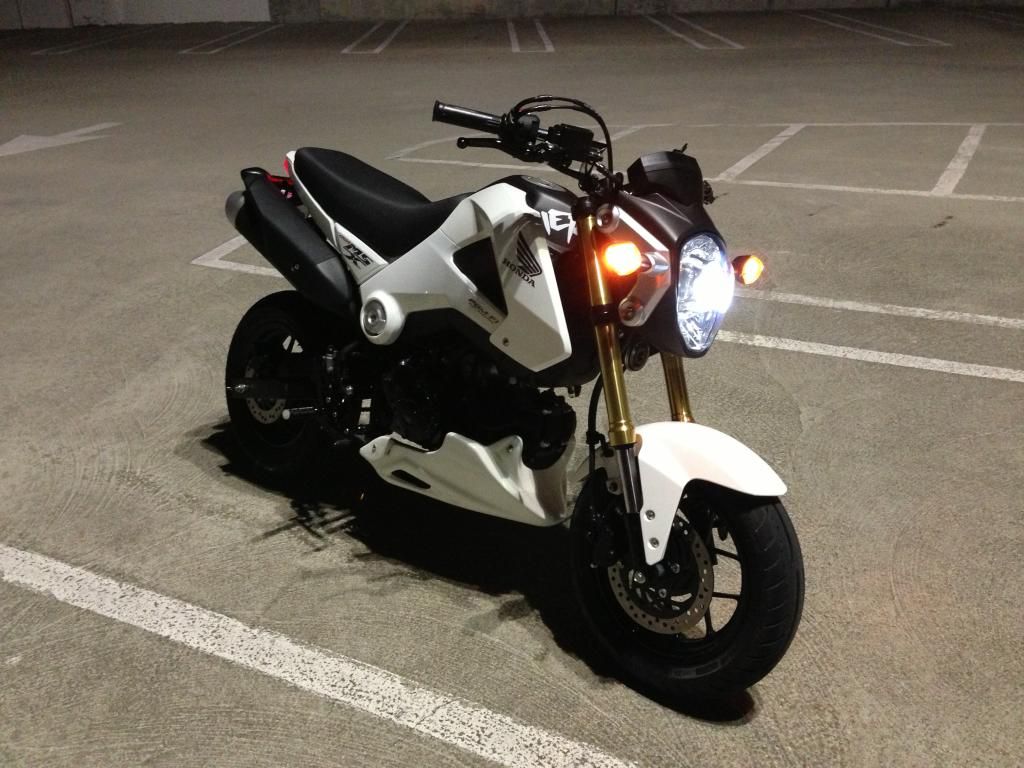

First mod @ 26 miles - Chrome Clubman Handlebars. Had them laying around, and I love how these bars are on my '63 Cub. I know it's a completely different type of bike, but I like how these clubman bars actually fit on the GROM. Compared to stock, it's about 2 inches lower, and from front to back, angled more, instead of being generally straight across like a drag bar.
Also tried mounting the clubman bars the typical downward way, (somewhat mimics angle of clip ons) but there wasn't enough room for the bars to rotate towards the back of the bike, to have the bar more level, so I mounted them upwards.
Rode with the clubman bars upward, and loved it. Went around the neighborhood and it had me at a much more comfortable position during cruising/riding. Slow speed sharp sharp turns are slightly difficult because these bars are lower, and right before lock my wrist comes to about an inch of my knee, and if I move my knee away from the tank covers, they would touch. It's okay for me and I can ride comfortably with it.
