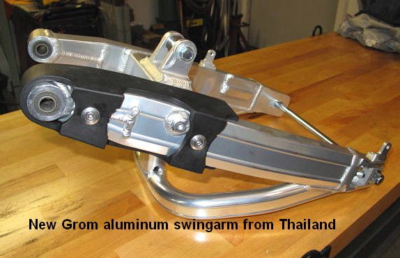

Hey all, enjoying my new Grom (Taiwanese for money pit :big smile:) and of course I have to farkle it. I have the usual goodies coming in (pipe, pegs & FE) and I have been eying swingarms.
Who are dependable sources for these? I want an unbraced swingarm, probably in silver, but I have seen advertised a Ti finished (brownish?) one that sounds interesting.

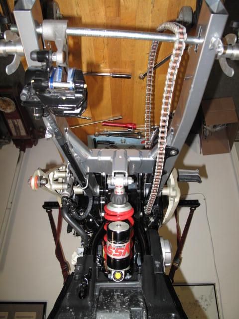

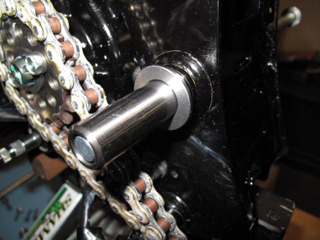

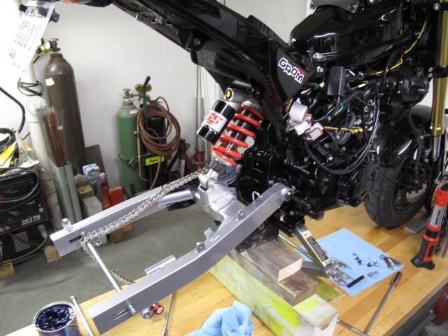

Brian S here, I'm the guy with the Japanese needle bearings for the swingarms. I attached a few photo's, I took off my aluminum swingarm, and replaced it with a chrome powder coated Honda swingarm. Both of the swingarms have my needle bearing kit in them. The needle bearing kit is not cheap, the bearings & hardened spacers from Japan are pricey, $195.00 installed, plus shipping.
The conversion does make a big difference in the handling. There is no reason to buy an expensive shock without doing it.
Brian
