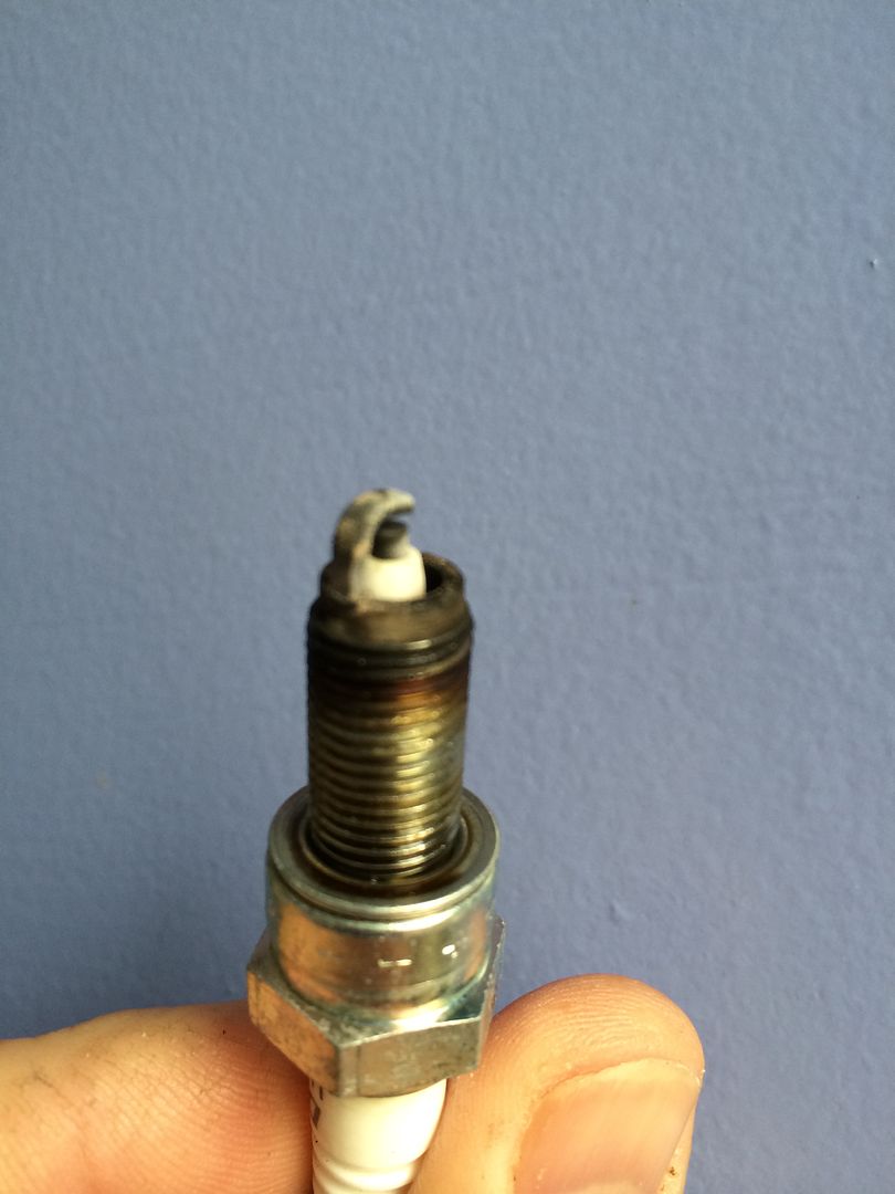

Since the air box mod I've been noticing a white (ish) tip of my plug. She runs great but I'm a tad nervous of running too lean. Will a PC help? I'm not really tech savvy so is it difficult to set up? Especially since I have really no idea which way to set it up with what I'm noticing. Thx for all advice in advance!

Im running full exhaust and a custom air filter. Mine is pretty clean on the plug but the factory computer has adjusted for the mods. You bike should be fine. If you would want you could go a step colder on the spark plug. For me the colder plug helped out a bit.

Either way OP your bike is fine. :) It will adjust for the air box mod no problem.

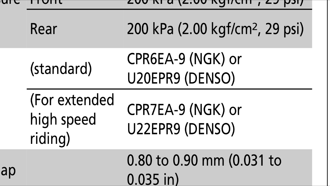

Thanks, I'm not looking for someone to do the research for me but mind telling me on how to go about looking? I'm very lame in the plug knowledge dept. The factory plug was white on arch, then someone suggested this which I think he said was a racing plug and the same results.

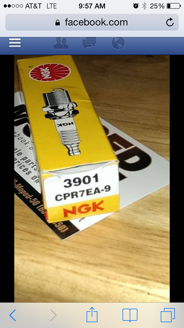

Ngk plug. You need a 7 or a 9 I forget

I picked up this same NGK (7) plug over the weekend as mine from Factory was the Denso. (6)
I will check it out after a few km's to see its color.
