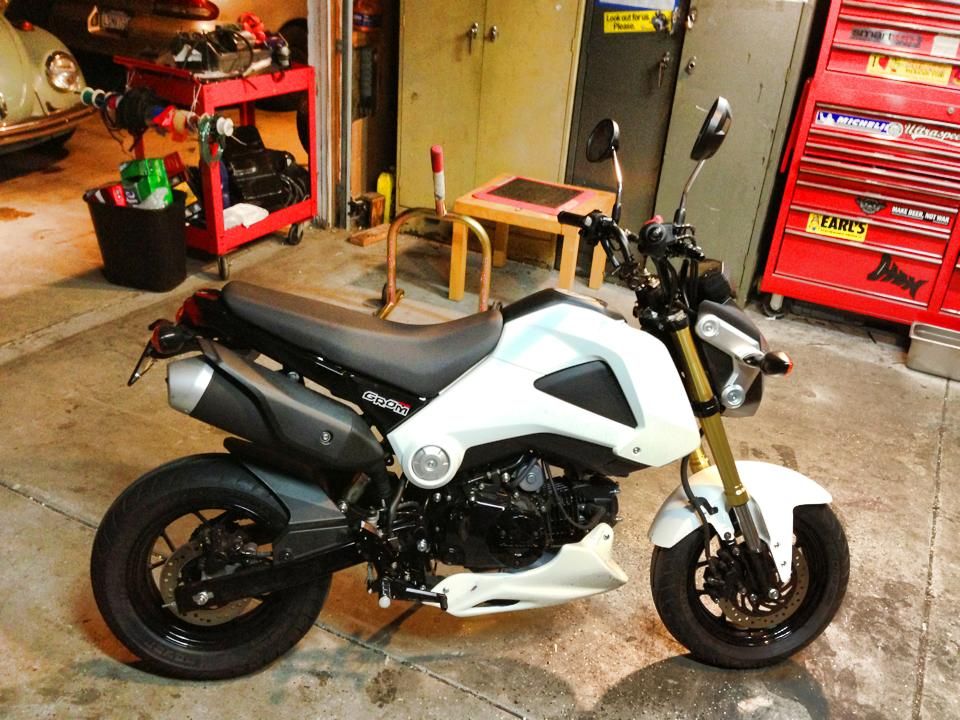

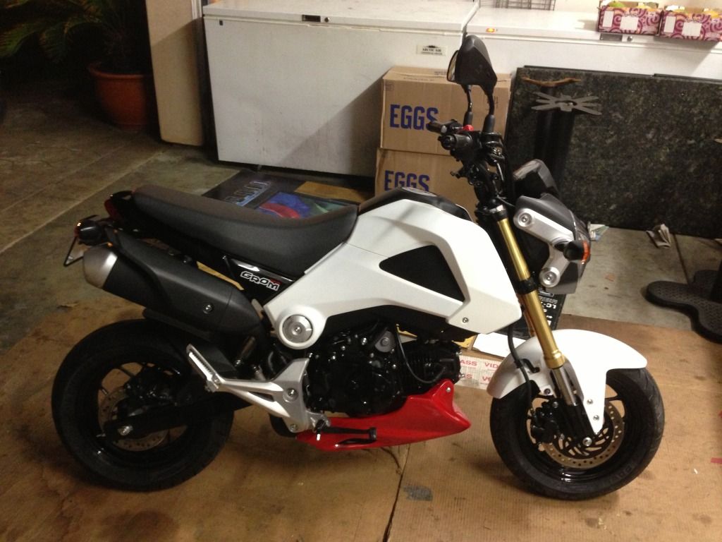

stock rear set
aftermarket rear set
Roughly 4 inches back vs. stock? It can be adjusted to go another 1/2" or so.
Is this the rear set that Jeankysti is distributing? (Could have misspelled that) Definitely what I'm looking for.

I'm pretty sure all of the good adjustable rearsets move your feet into a higher position for cornering clearance, even in their lowest position. I use Over Racing, and have ridden a bike with Driven rearsets, both are higher up than the stock grom rearsets. Tyga's look to be the same.
