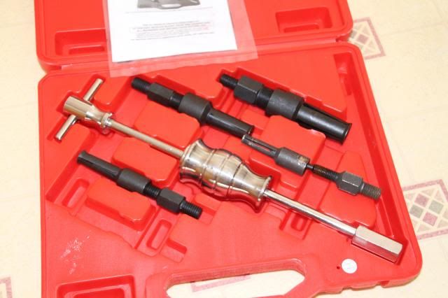

here is the tool you should get from HFT
Search results for: 'blind hole bearing puller set'
It comes with a case and if you can get a 25% discount coupon found in most motorcycle mags, or American shooters mag or when HFT sends you their adds than you'll only pay around $54 well worth the price.

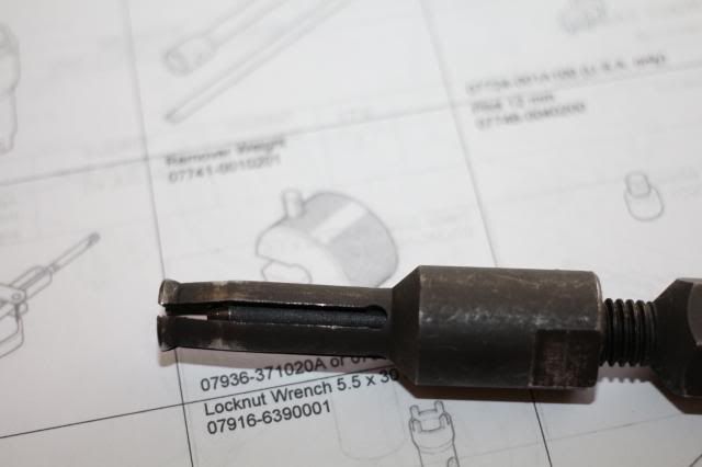

Make sure you push this part down to where it seats on the bearing and tighten, that way the tool head will not slide out and get you frustrated like I was getting.

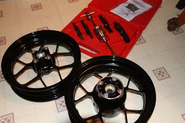

Grom rim with bearings out
front rim, bearings gone
rear rim, bearings removed
Now time to remove the black paint and get the rim ready for custom paint/powder coating
