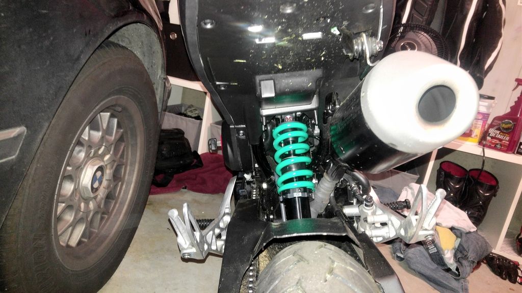

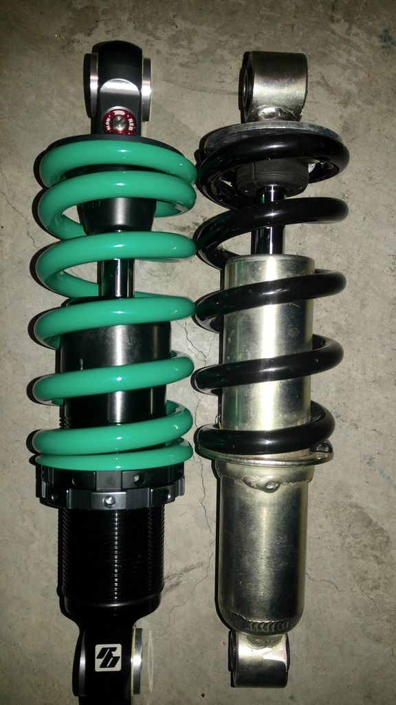

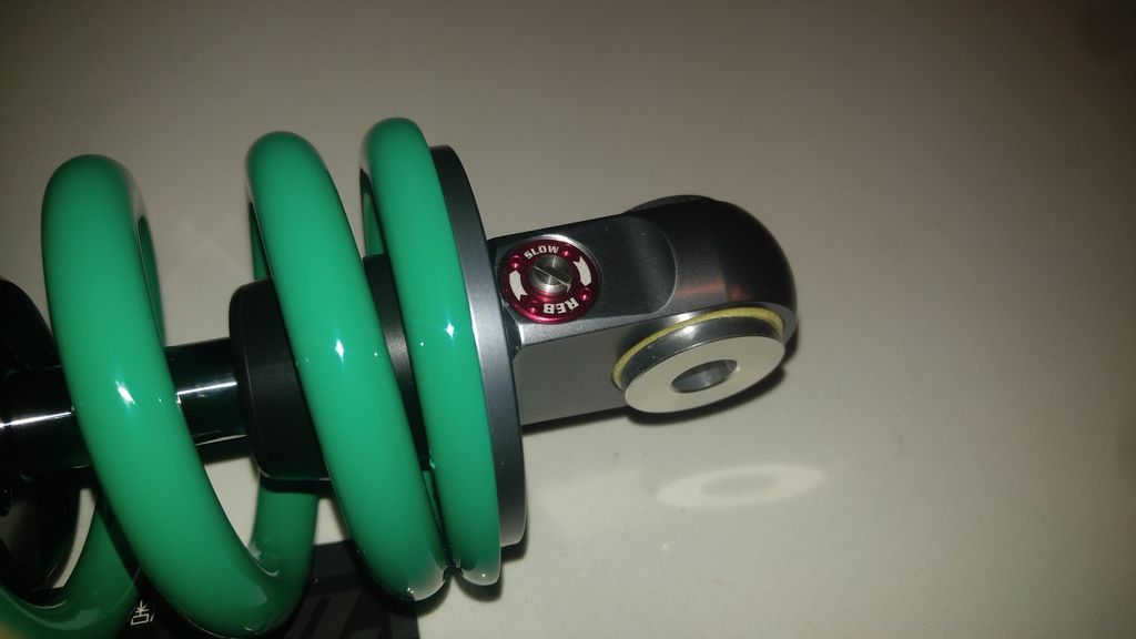

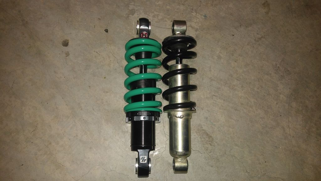

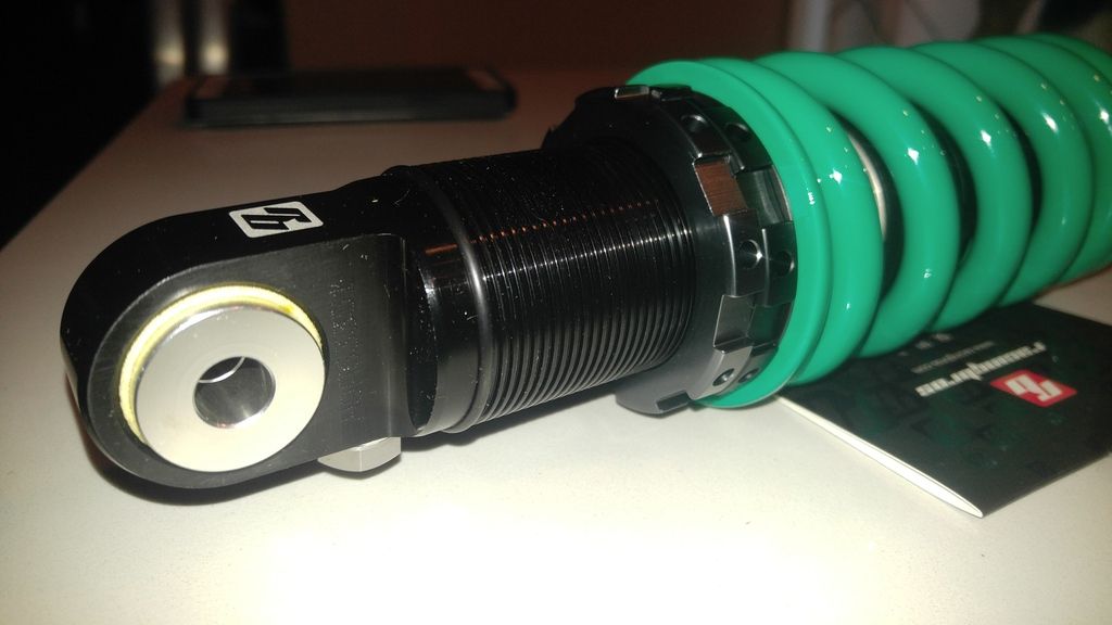

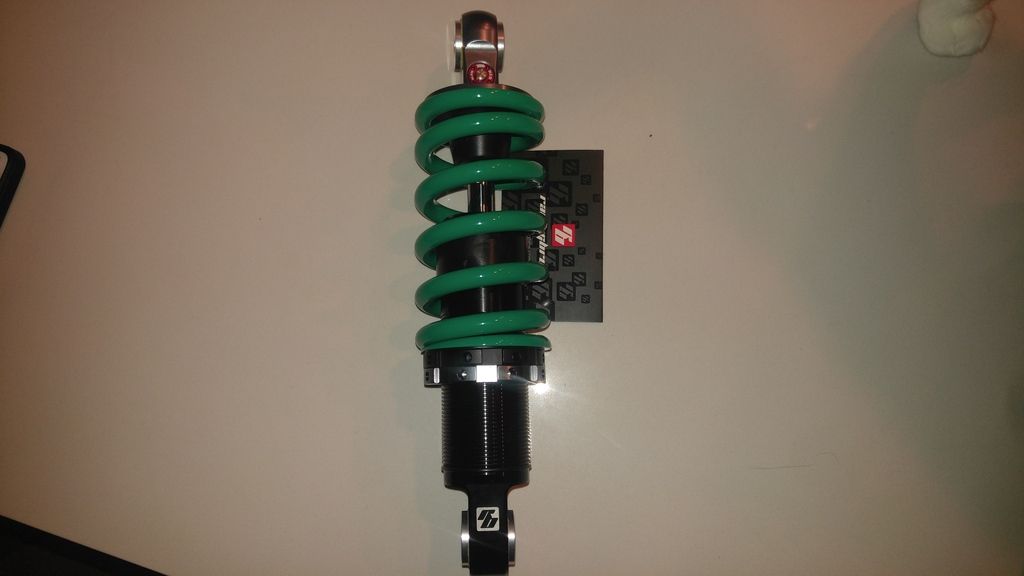

Shock came in the mail today. Quality is good. I am a little surprised by the small amount of travel that it seems to have, maybe 2 inches of shaft before the bump stop. I ordered it with the 100nnm spring which of I remember right is rated for 180lbs, I'm about 155 without gear and had to tighten it up about 1 turn on the collar to get the sag right. The clicker for the rebound gave decent feedback but is a bit hard to get to. I won't be able to give a review on it as it's raining and I don't really want to give an opinion on it before I get the fork cartridges installed and it gets the chance to work as a unit.
199 Posts
The stock rear suspension is 4" at the axle, the stock shock only needs about 1.5" stroke to achieve that.
the racing boys shock has slightly more stroke, increasing travel slightly, the bottom out bumper on the racing bros a bit longer making it look like less stroke.
Its not a motocross bike it's not ment to have gobs of travel!.
The quality of the racing bros gear is exceptionally good. Side to side with ohlins there's nothing in it really, if anything the racing boys is nicer and at least it doesn't look like it was made in 1990 like the ohlins shock does, can't work out why they don't update there design with something modern, especially since the counterfeiters have the old school look down pat. The ohlins piggyback shock looks quite disgusting on the SF model which is probably part of why they made the reservoir unit. not too bad on the old grom though.
i have my rebound adjuster mounted at the bottom and it's reasonable easy to get to, that being said my piggyback makes mounting the other way impossible.
give the shock at least 10 hours use before commenting on it, as with anything like this there is a break in period before it performs how intended. You'll find you need a little more rebound adjustment after the first few rides.
