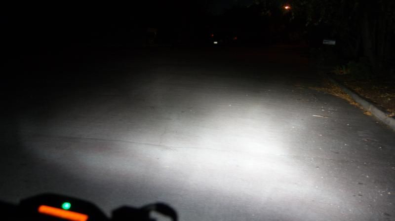

Lighting Light Night Asphalt Driveway
That is a Thai light with HID. Why not just buy a quality halogen bulb and not have light scatter all over the place? D2S is not made for reflectors, period. The cutoff rotates when you turn, but maybe I am not riding aggressively enough for this to become an issue. Just something about awesome light output and spread that just does it for me.

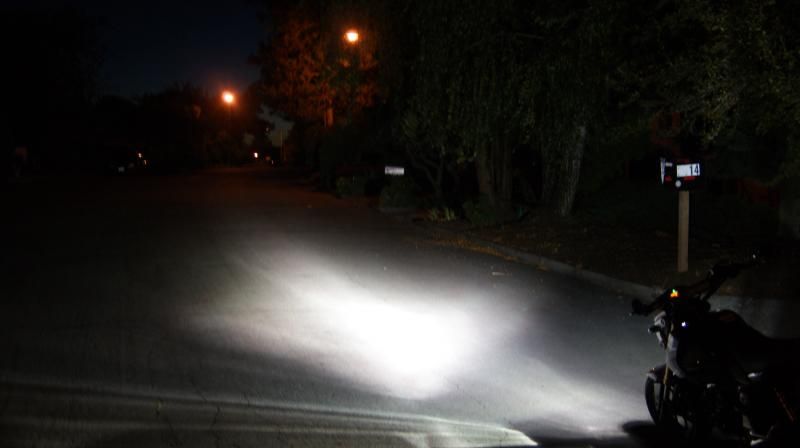

Night Light Lighting Road surface Sky

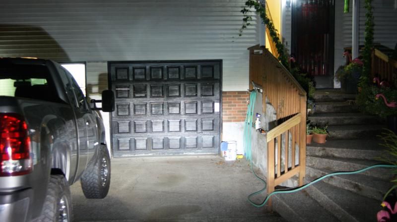

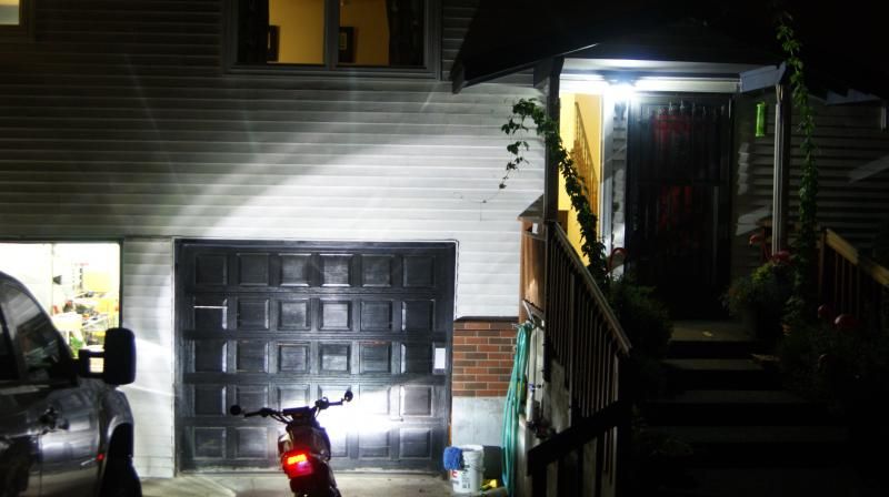

Here are few of mine with my pnp kit with Hi/low bulb. Yes it does have glare, but the beam is right in front of me. Have not been flashed yet.. I have a shield on the bottom of my bulb so that might make a difference that just a normal hid bulb.

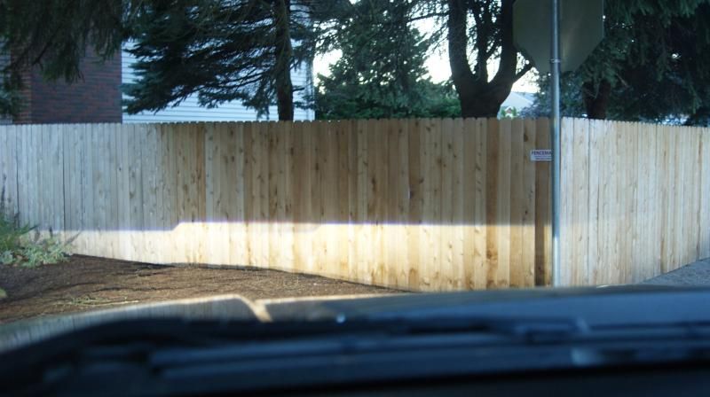

Here is my mini H1 6.0 cutoff in my truck

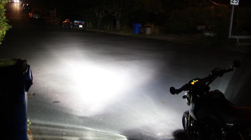

I do have to agree about the moving cutoff. On stock suspension my cutoff is a bit bouncy with a Mini H1 6.0, but I think vacuforming the projector may help that a bit. I installed my retrofit a while back and was really happy with the output and beam pattern, only issue was the damn bouncing. Here is my cutoff on the retro for the Grom:
