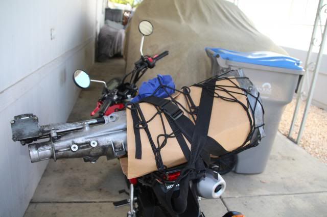

the thing about the Grom build that I like is that you will learn about A/F mixture and adjustment, A/F mapping, electrical wiring and do's and don'ts, brakes, tires, suspension setup ,lighting and many more topics about the Grom that will apply to other motorcycles that you buy or get down the road of life. It will make things that you think that you could not or would not do possible. Great learning tool for the future of your motorcycle riding and great people that share information and also the love of motorcycling no matter what size the engine is.
I do like seeing Grom owners that do expand the possibilities of the Grom and show the world that just because the Grom is small in size it can be ridden from Santa Cruz to LA and back, through the Alps and UK mountain range, through the cities of Thailand/Japan/Asia, from Oregon to Alaska and carry many types of Load.
