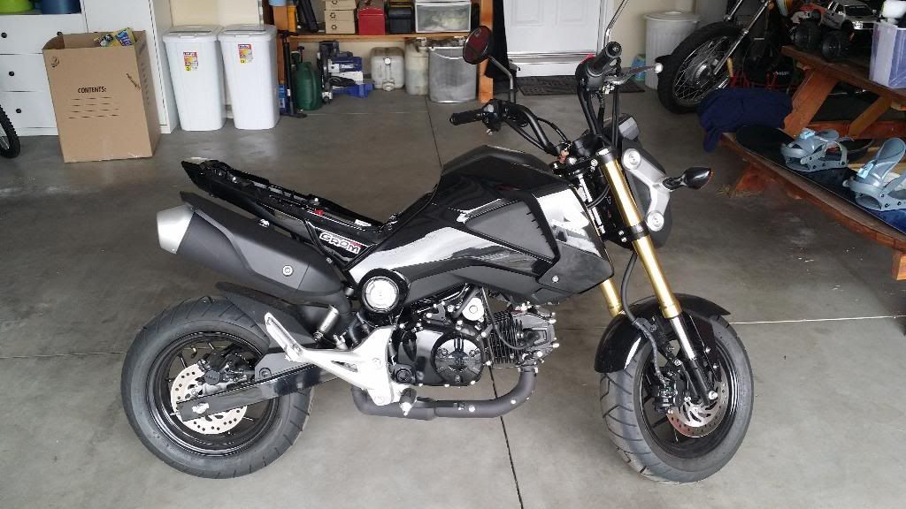

I picked up my Grom here in Boise the week they came out in August. Called and the dealership had 2, and my buddy TheMadSupra and I scooped them up. I had a Ruckus that I'd done a ton of stuff to, but I wasn't really into it. I sold it a couple years ago, and while I didn't miss the Ruckus, I did miss riding. I'm not really in to bikes, but I do enjoy these small, highly modifiable, Japanese bikes, so when the Grom came out, I was all over it. Didn't do anything to it in the fall except for the MNNTHBX fender eliminator, but I started collecting parts over the winter. Not sure what else I'll do to it, but we'll see. I plan to go to Japan for Tokyo Auto Salon next winter, so modding my Grom and my 350Z will probably take a back seat this year.

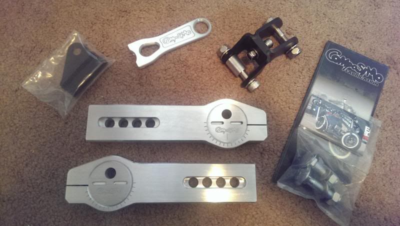

Composimo stretch kit w/ 6" lowering mount

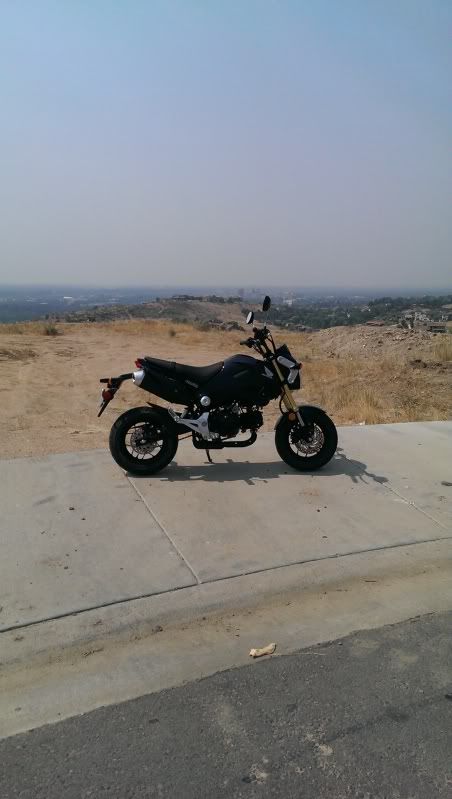

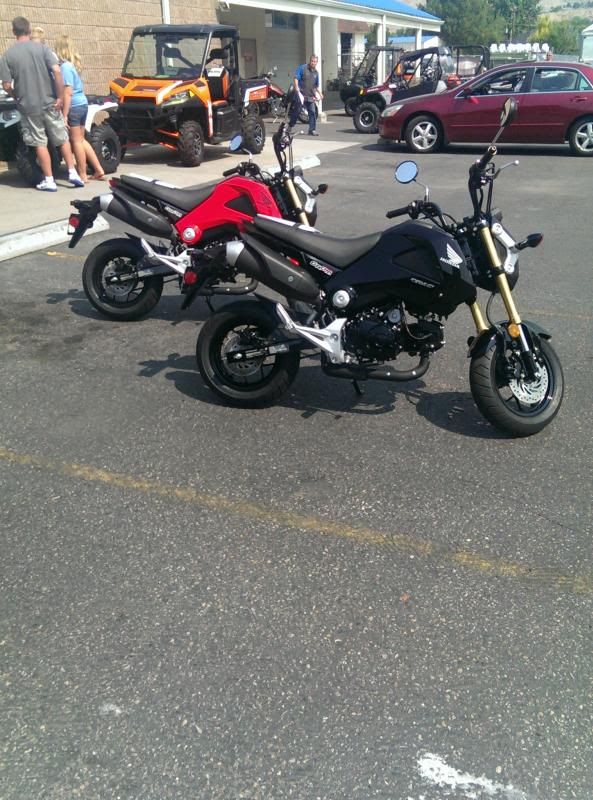

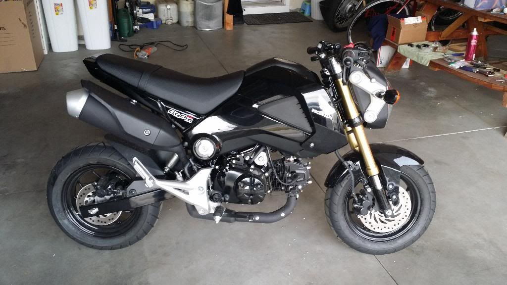

Here she is at the dealership when I bought her:
Out for a ride the first weekend:

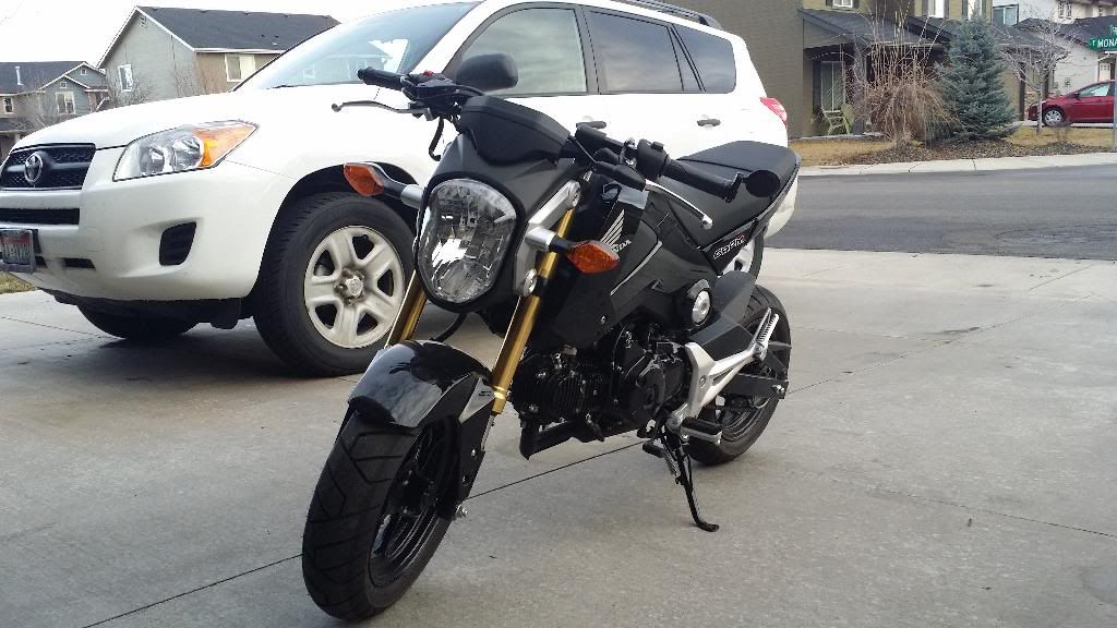

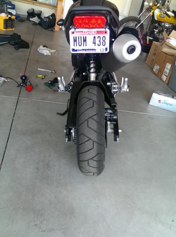

Got rid of the giant rear fender thingy:

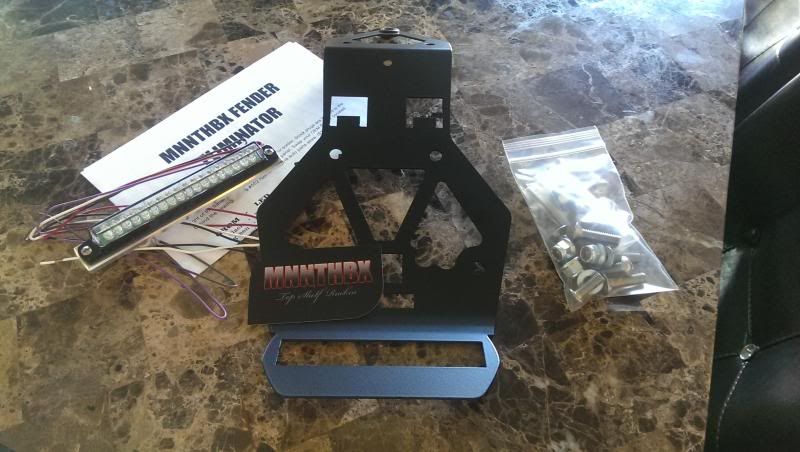

MNNTHBX fender eliminator:

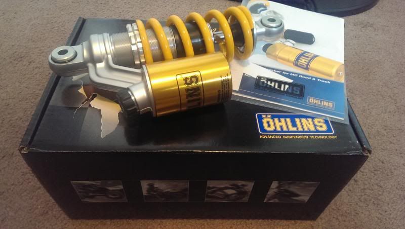

Started collecting parts. Here's the Ohlins coilover:

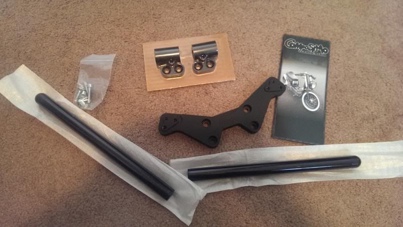

Composimo RaceBarz:
Composimo stretch kit:

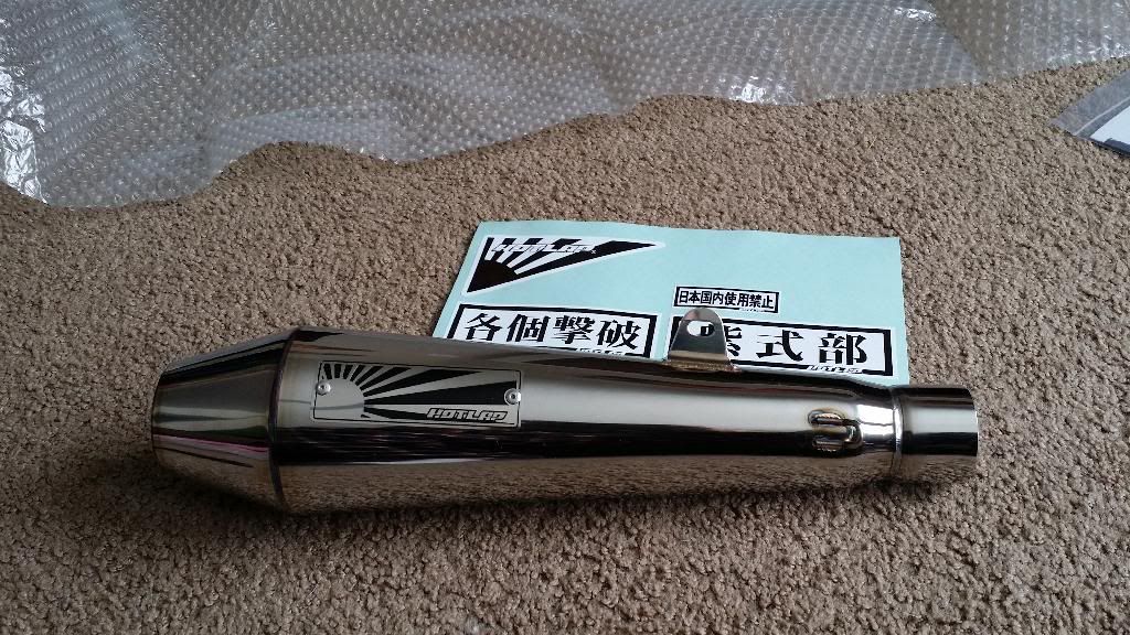

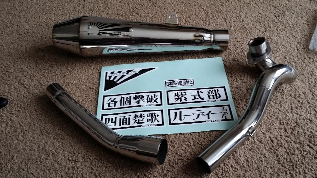

Hotlap Boso-Ichibanboshi exhaust. This thing is a work of art!

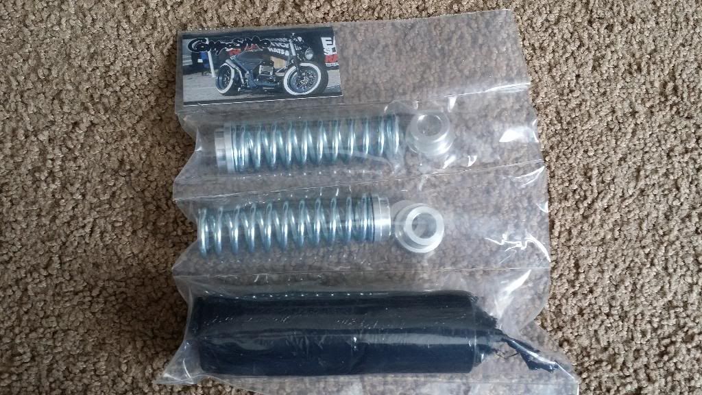

Composimo 2" fork lowering kit:

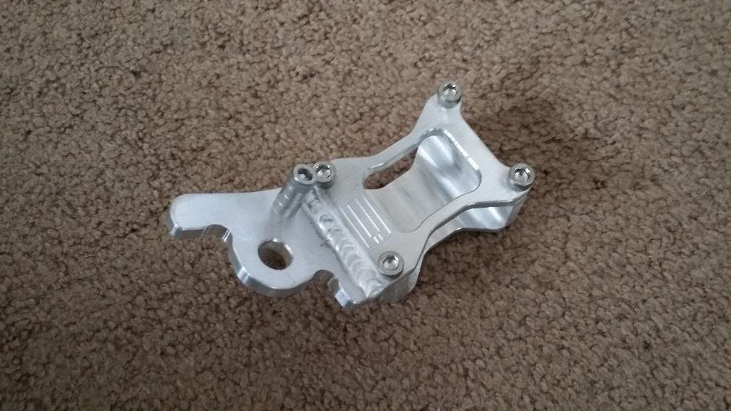

Composimo swingstand kickstand mount:

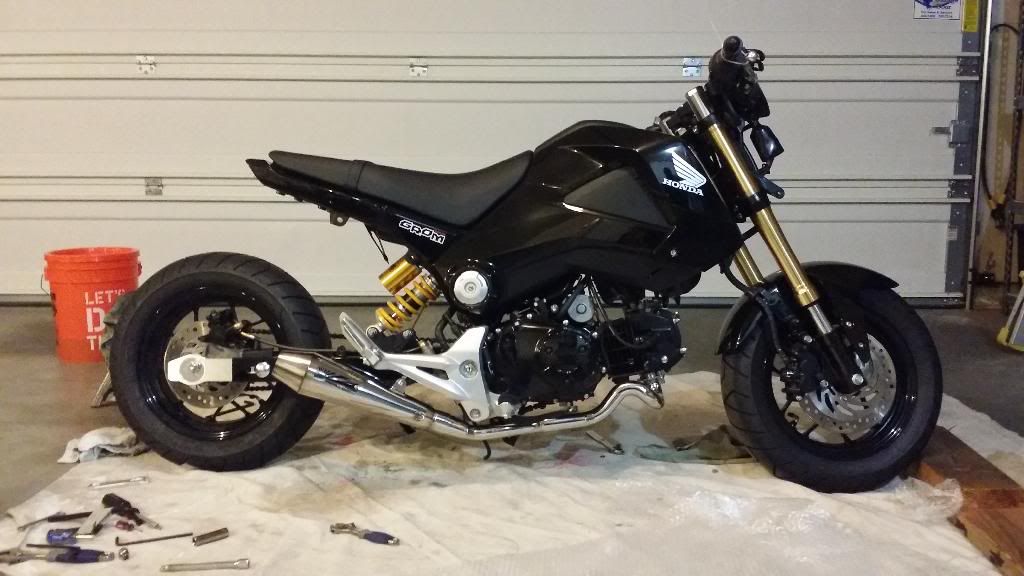

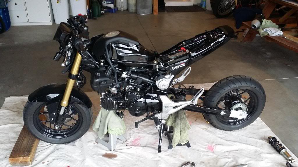

Now, after collecting all the parts I wanted, it was time to get to work. It's now March and spring is coming!

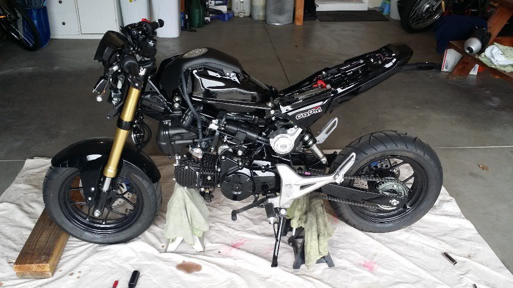

Spent part of Saturday afternoon getting the bars and fork kit on.
Ready to mod:
Bars mounted:

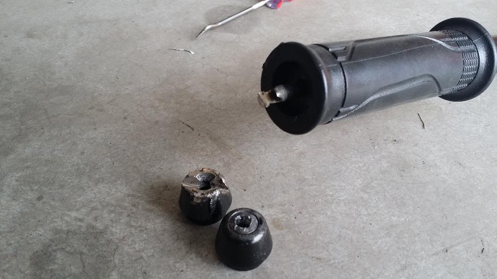

Stock bar ends are a son of a gun to remove! We had to drill one out, and use a grinder to get the other one off after our bit broke off in it:
End of Saturday modding:
CRG Blindsight mirror:

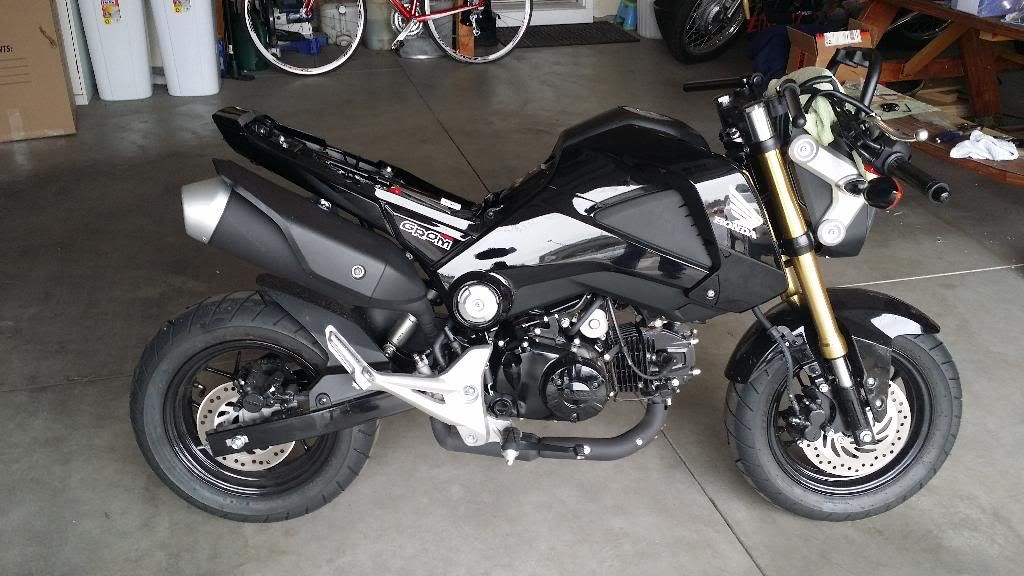

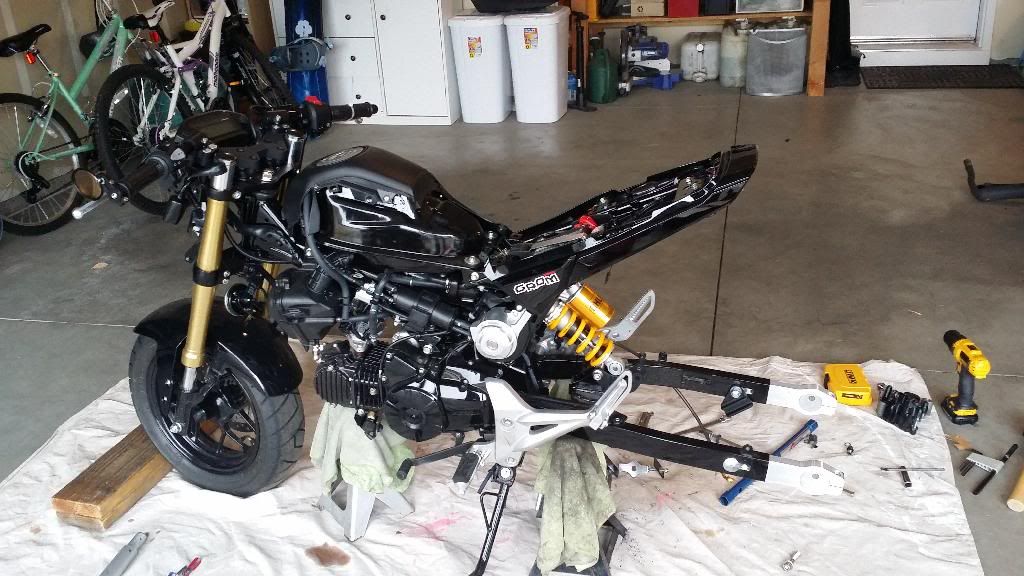

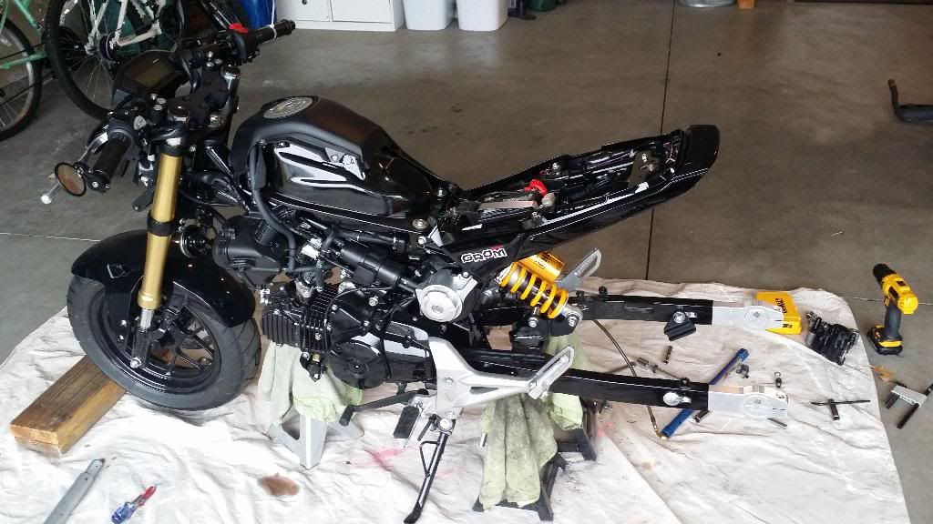

Sunday. Time to get the extension and coilover mounted.
Getting set up:
Jackstands on the swingarm, one under the motor just in case, and a board under the front wheel:
Super custom brake holder!

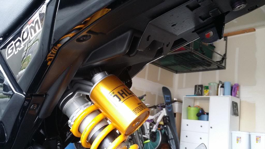

Extension!
Ohlins!

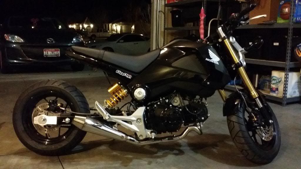

Wheel back on:

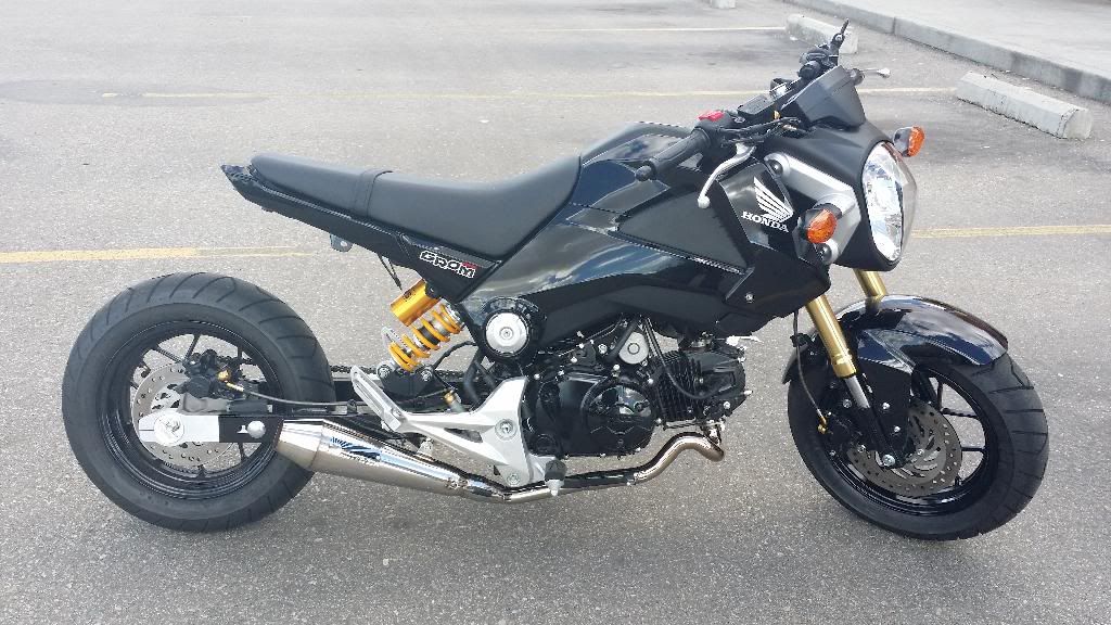

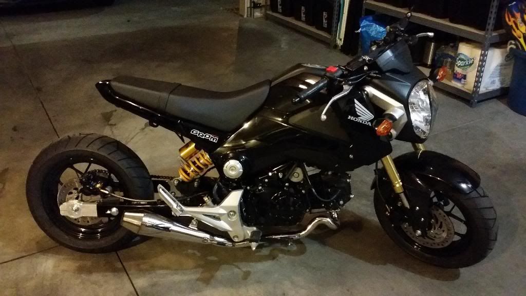

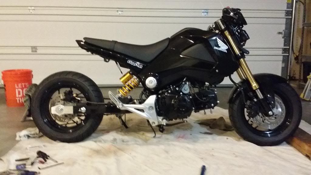

Back on the ground:
Was late, but we wanted to see and hear the Hotlap exhaust, and it didn't take long to mount:
Later in the week, bled the brakes and mounted the headlight:
Took her for a ride to Fuddruckers for a burger. The stock kickstand mount is hitting the ground on left turns...Ugh!

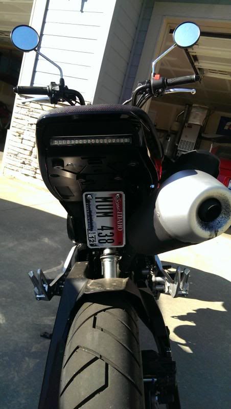

Had to trim down the license plate mount on the MNNTHBX fender eliminator. It was hitting the Ohlins reservoir just barely. I still need to smooth and paint this section.
Wanted to ride on Friday, so I just found a bracket in my garage and made a quick license plate mount. I'm making a new one, in the process of painting it.

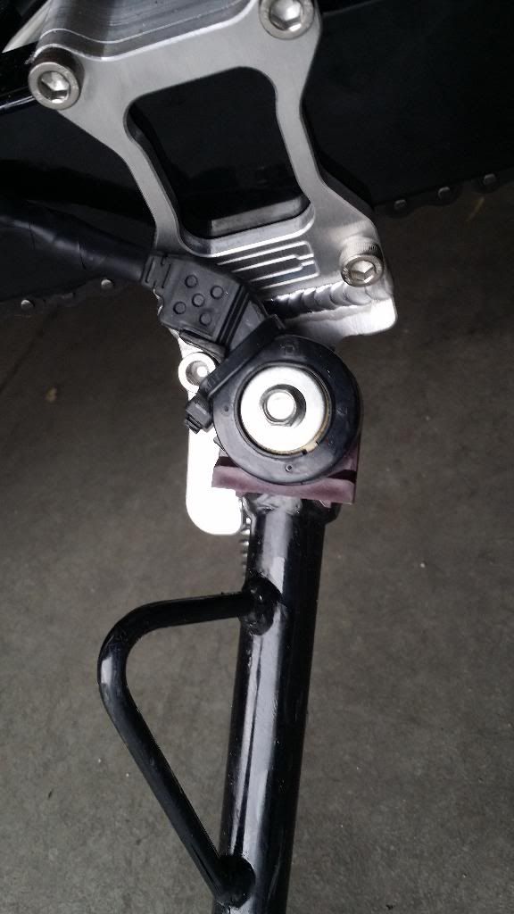

Rerouted the kickstand sensor to the Composimo mount:

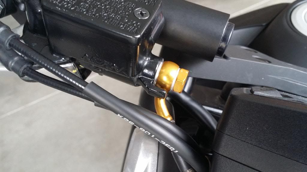

Front Spiegler stainless brake line, with gold fittings. MNNTHBX's site says they come with factory grommets, but mine did not, so I re-used the stock ones:

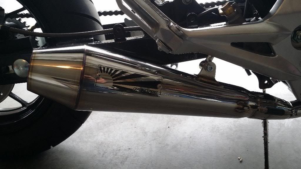

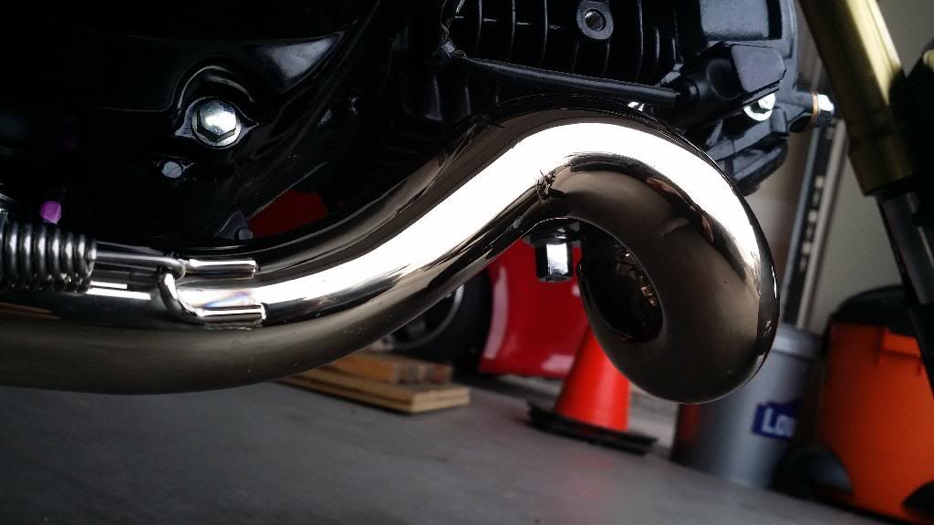

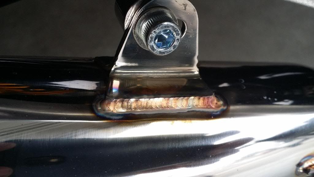

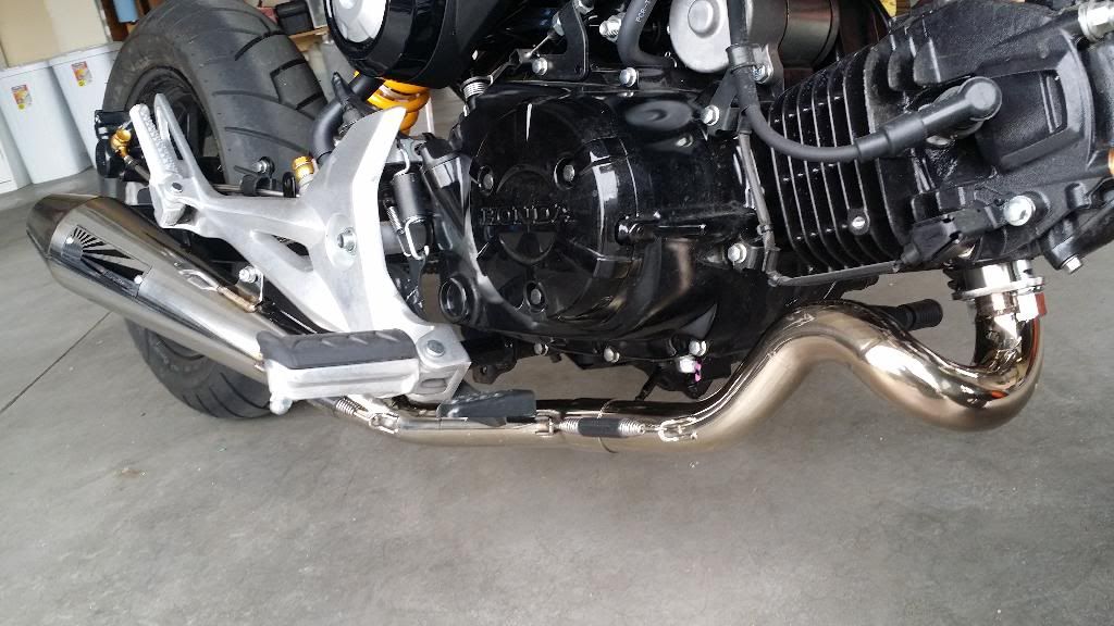

Closeup of the Hotlap exhaust:
Rising sun!
I love the bend of the header!
Beautiful welds from Hotlap!

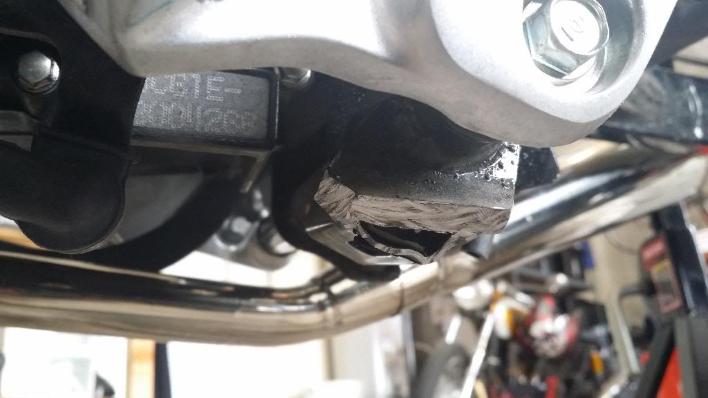

Cut off the stock kickstand mount. I smoothed and painted it last night, but haven't taken a pic yet:

Looks awesome! Btw the ohlins shock can be mounted upside down. I have noticed it's mounted that way on the other lowered and stretched groms.
Wow! Where did you get your Hotlap pipe?
I ordered it from Minimotolab.
Where did you pick up the black Composimo bars from?
Yeah, you can just pay an extra $20-$25 or something like that and he'll PC it before he ships it.
Thanks man! I'll have to do mount it upside down this weekend. The cap on the reservoir is hitting the plastics on the underside of the seat and I don't want to damage that cap somehow.

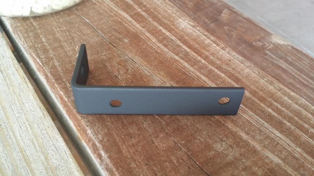

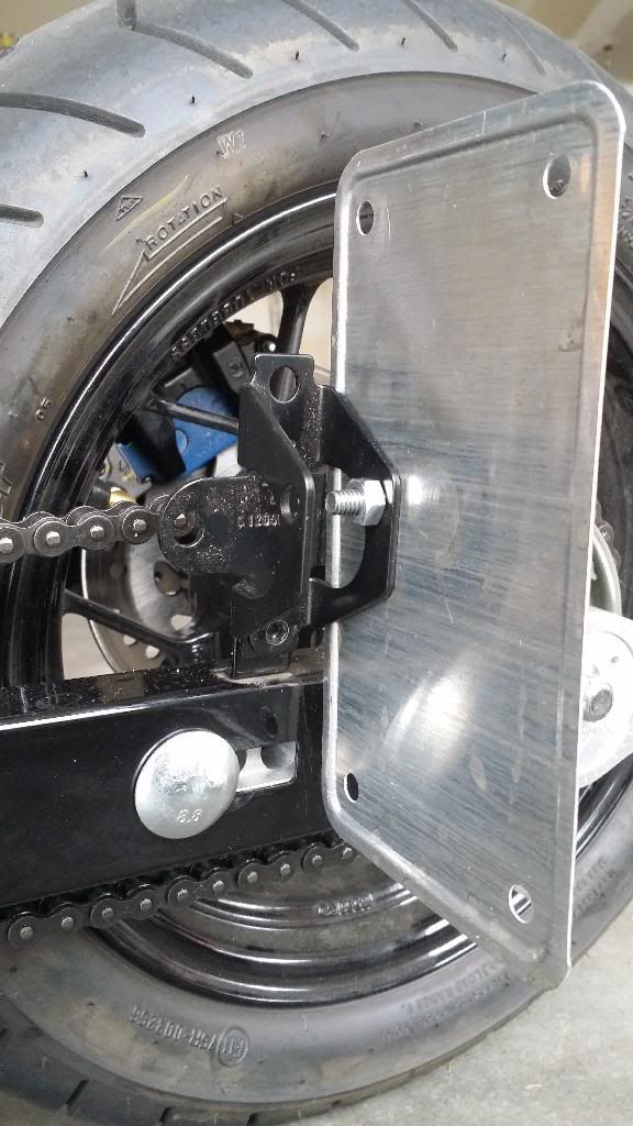

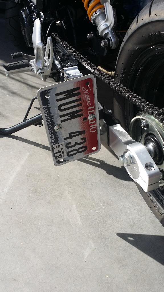

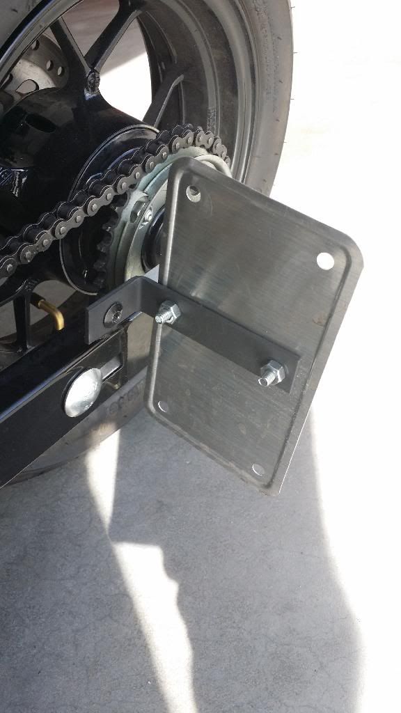

Completed my super custom license plate bracket. I mounted it towards the back of the swingarm where the fender was attached, using the stock hardware.
I put a rubber washer in between the swingarm mount and the bracket. Nothing fancy, but it's functional and should keep me from getting harassed by the Five-O!
