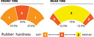

Here is what I was talking about. Note the huge difference in the new and old tire size before it is mounted that is....go to 4:50 and see the difference between a tire that has been mounted and one that hasn't.
That is a rear tire and the compound is a bit harder than their front tires. .
Actually you're dead right.
Do you know if there is any markings on the tyre to denote front and rear?
