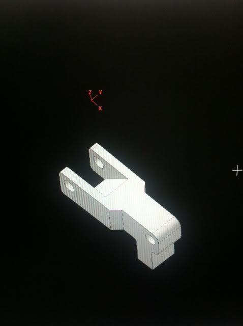

Got a few minutes to play around at work today and drew a quick model of how I see the lowering link working. I plan to tool path it this evening and run a prototype tomorrow or Saturday. I already see something in it I might want to change but I think it will be easier to throw one on the bike and then see what change I want to make.

well..... because it looks really hard.... just to be honest haha that was my first thought and I looked at pictures of the ones companies have for sale and I said hell no! too much material and detail to make it really worth while.
