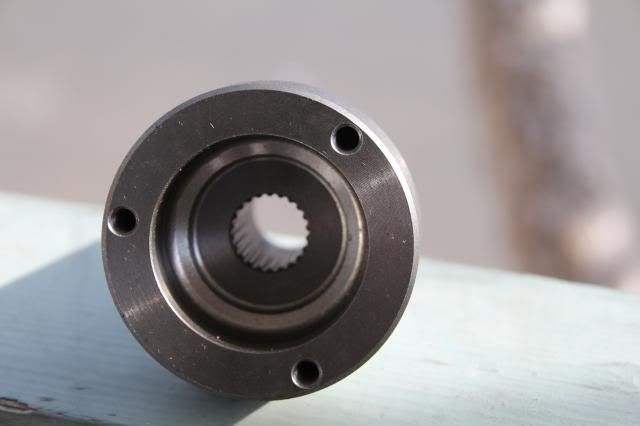

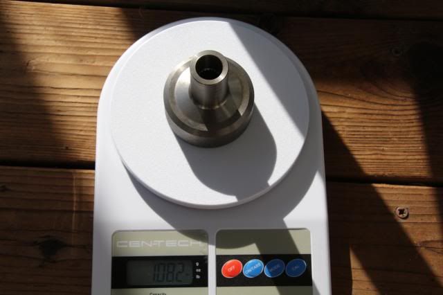

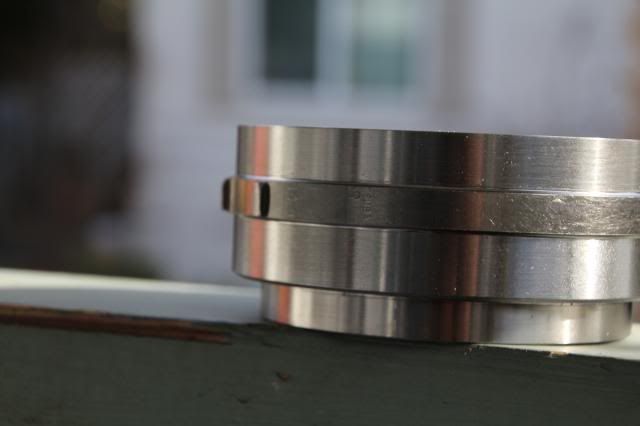

Just received my lighten flywheel and oil spinner back from JCracing. These lighten parts should give my Grom motor a faster spin up time and cruzing speed between 20mph and getting on the throttle a faster response.
Here is the Flywheel before and after wt and pic
Flywheel wt before sending out, 2.6 lbs or 1210g
after lighten 2 lbs or 919g,
notice the metal was machine from both sides of the magnet pick up tabs which there are 9 of them.
The oil spinner before sending out for lighten, 2.27 lbs or 1030g
after lighten, 1.08 lbs or 492g
notice the amount of machine work, it removed the outer layer 3 holes
