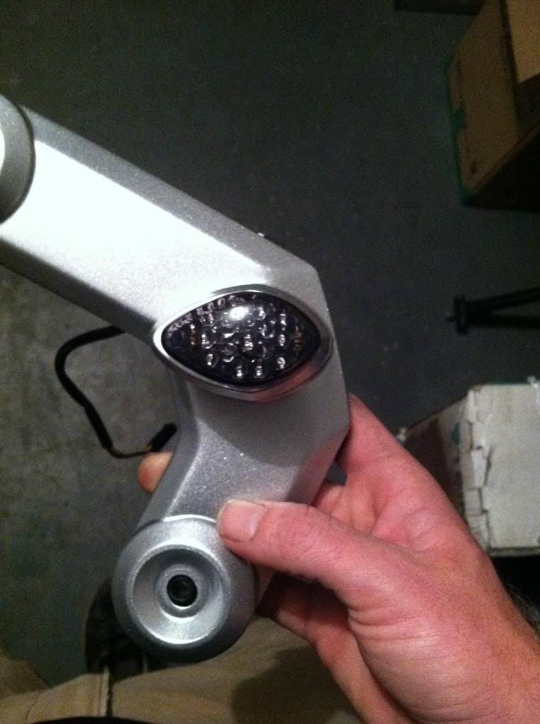

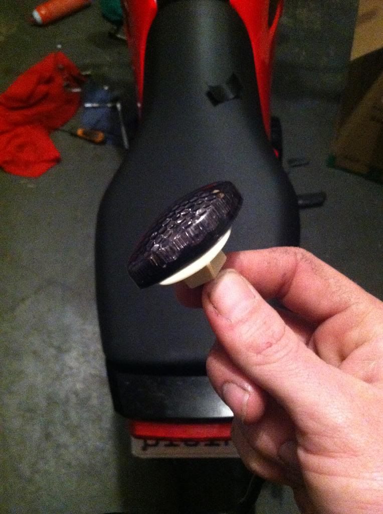

I don't know if this is common knowledge since I'm pretty late to the turn signal party but they're plug n play and mounting them only requires snipping the nylon back nut into a oval shape, you set the light against the signal plate and slide the nut down the harness down to the back of the light, spin the light in circles to tighten it together.. once it's snugged down clip the lights into the female connectors on the harness and you're done!
