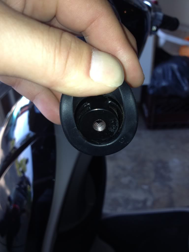

Also the factory bar end weights were installed by a gorilla on meth. Apparently they are super tight. The screw holding them on is a #3 Phillips. Use a #3 Phillips bit in an impact driver. Have a buddy hold the opposite handlebar or put it against a wall or something so that you can pound on the impact driver. The main reason for this would be to remove the screw, not necessarily to save it or keep from messing it up or striping it because it is specific to the factory bars. If you are changing bars, you will not be able to use the factory bar end weight. I suppose in that case you could darn near use a Sawzall to cut them off.
