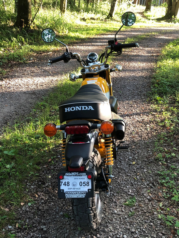

Today I picked up a 2019 used Monkey and in riding it home find the rear springs bottoming on a few places. I'm 185# and would like something with a bit stiffer springs, but affordable so high end stuff like Ohlins are out. It'd be nice if the springs were yellow to match the original but if not black is ok. Other than Beez Deals, which have black adjustable, but they don't give the spring weight, any suggestions?
Loving this little bike so far! The oblatory first pics. :)
