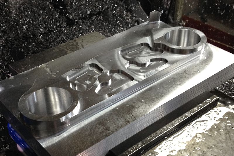

· Vendor
2,186 Posts
I have guys flying in from Michigan and Illinois Tuesday to collaborate on just this project. We have been machining custom fork lugs and triples for a week. In a matter of weeks, I'll have WORLD CLASS, USA made, FULLY adjustable fronts end kits. No imported scooter pieces. They will not be cheap. There's simply no way to do this type thing on a budget. For those that want real suspension, it will be awesome however....
