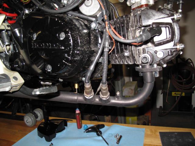

Latest DynoJet Grom Beta Version PCV & Autotune Data
Guys,
The weather has cooperated for the last week. I have been able to get about 30 miles in, although most of it was ridden with thermal underwear on.
I’m on the 4[SUP]th[/SUP] revision of the PCV Honda Grom map. I’m running from idle to WOT in a range of 12.8 / 13.9 to 1.
It appears that the Autotune is the KEY to the problem.
Below is a list of the Grom engine combination at this point:
2014 Honda Grom
SRD Kick Ass 170cc big bore kit
Honda PCX150 fuel injector, +25/+35 greater fuel flow
Stock camshaft
Stock cylinder head
Stock throttle body
Modified air box ( radius entry, mesh removed )
SRD tuned exhaust system, Cone Eng. Muffler, 5500/6000 torque peak
Daytona Systems wide band O2 sensor.
Honda EFI oem O2 sensor wire grounded to the chassis ground
Compression approximately 10/1
16 / 36 final gearing, measured / accurate 60mph reached sitting up
Once I have a finished map, at least at this point, the engine will get converted to the modified & ported Grom head and ram induction system that SRD built for this bike.
Guys, I can’t find anything wrong with this set-up
The combination of the PCV & the Autotune works.
