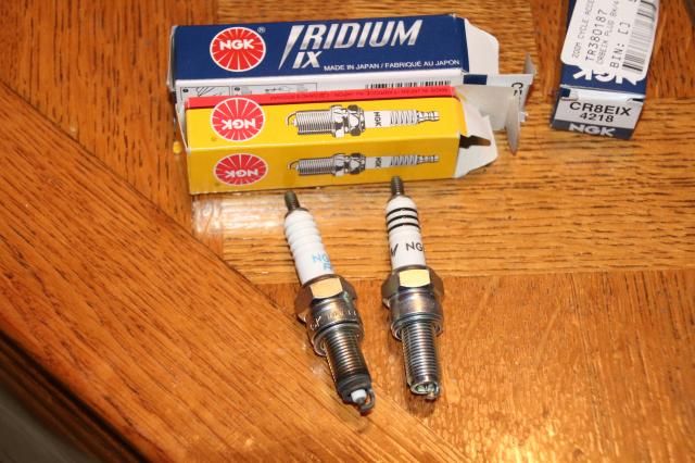

I've tried all these plugs
CPR7EA-9 the grom runs ok with this plug
CPR8EA, this plug is ok
CR8EIX-4218 this runs great WOT
I will test the CR9EIX-3521 today
The difference between the EIX plug and the CPRxEA plugs is the tip is very narrow and does not stick out as far as the standard plug plus the price is like $10 vers $4
