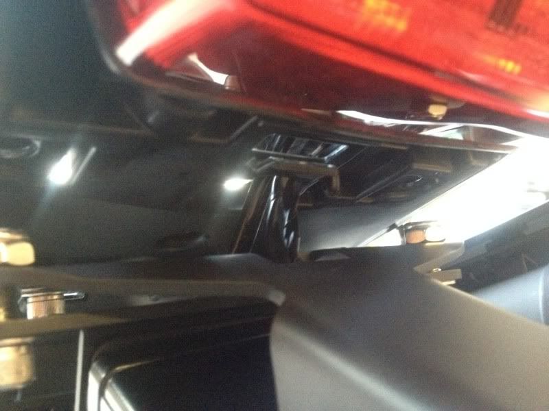

below shows how to run the wiring into the frame at the same location you removed it from.

wire up your tail lights, make sure that left blinks left, right blinks right. make sure you tuck the extra harness away. I did so by just folding it and storing it along the factory side where it is ran. you will have extra harness. remember you removed the fender and brought back the license plate light a great deal, this accounts for the extra slack,
