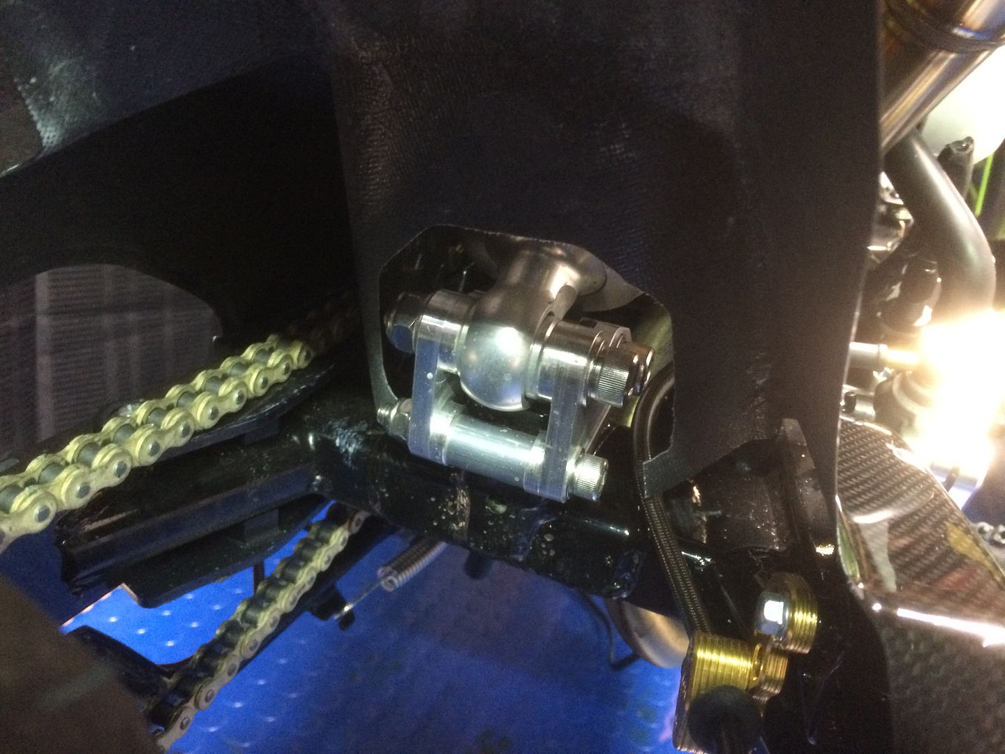

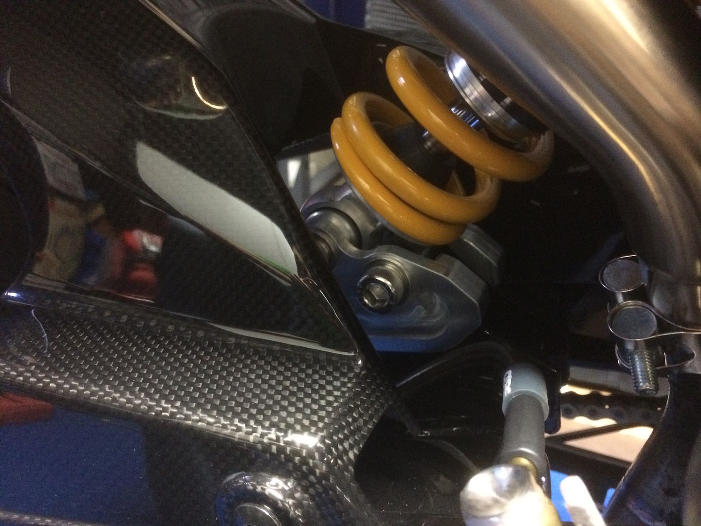

Hey guys... I'm not to sure what the confusion is with getting a hold of me... I'm definitely not "bullshitting" anyone... Lol! Please remember that this is not some huge company or anything, and I am not always by the phone during the day since I am usually out in the shop making parts, packing, shipping, etc.
anyway, it was my original intention to do a how-to on the rear link then ext time I had a Grom in the shop and could shoot he drilling ofth e hole... However by the time that happened, the Billet rear shock mount was already in development, and I have a Grom in the shop now that I will be doing a how-to on installing that instead since the steel mount that requires drilling is no longer being made.
between Facebook, Instagram, phone, email, text, etc I am very easy to get a hold of... If you called and didn't leave a message, I'm sorry, but as stated before, I am not by my phone most of the day.
anyway, it seems that the question here has been answered, but if there are any other questions, please let me know. Thanks!
