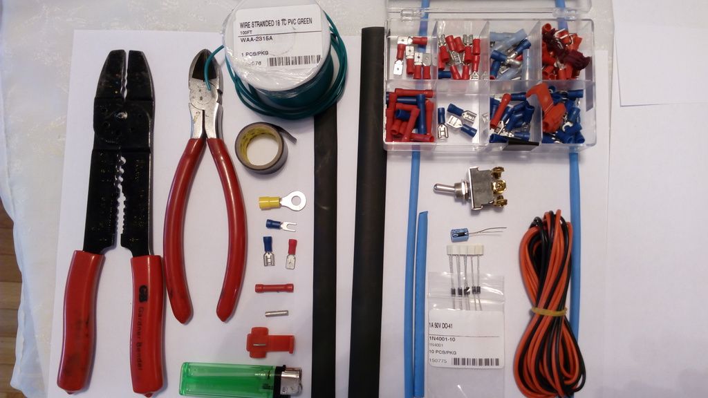

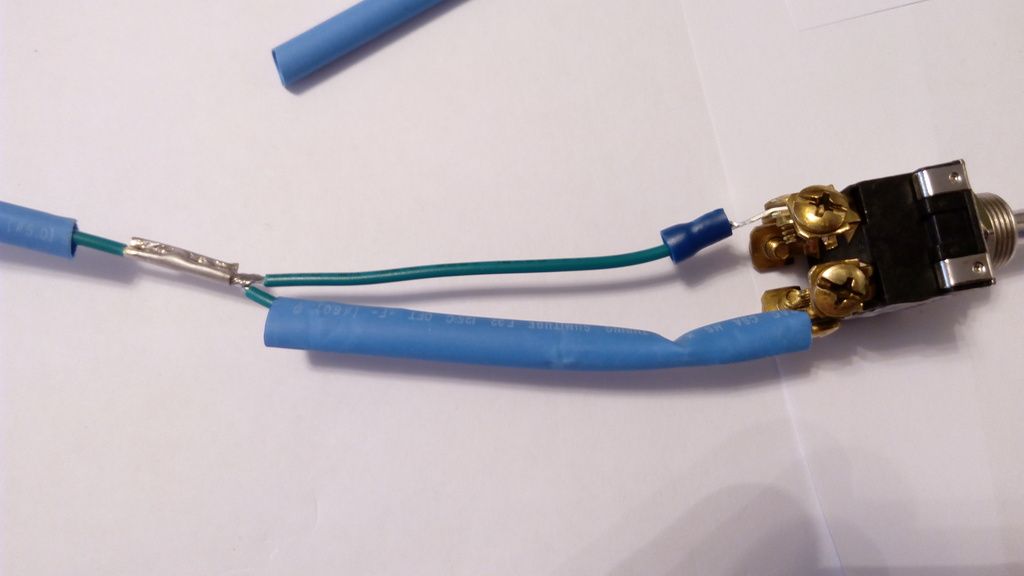

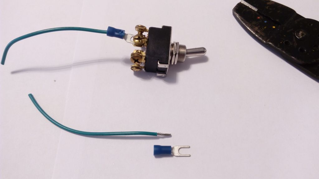

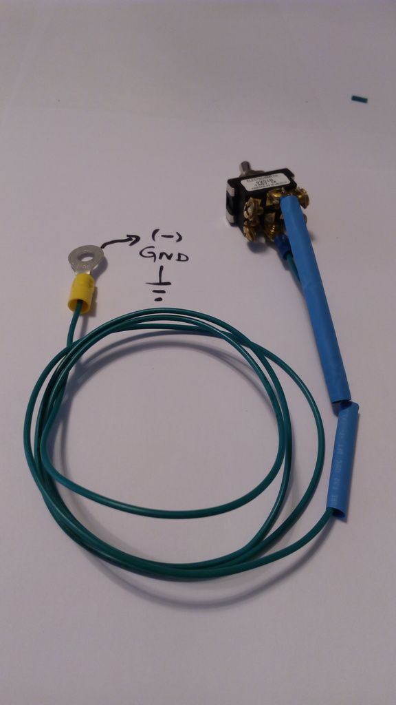

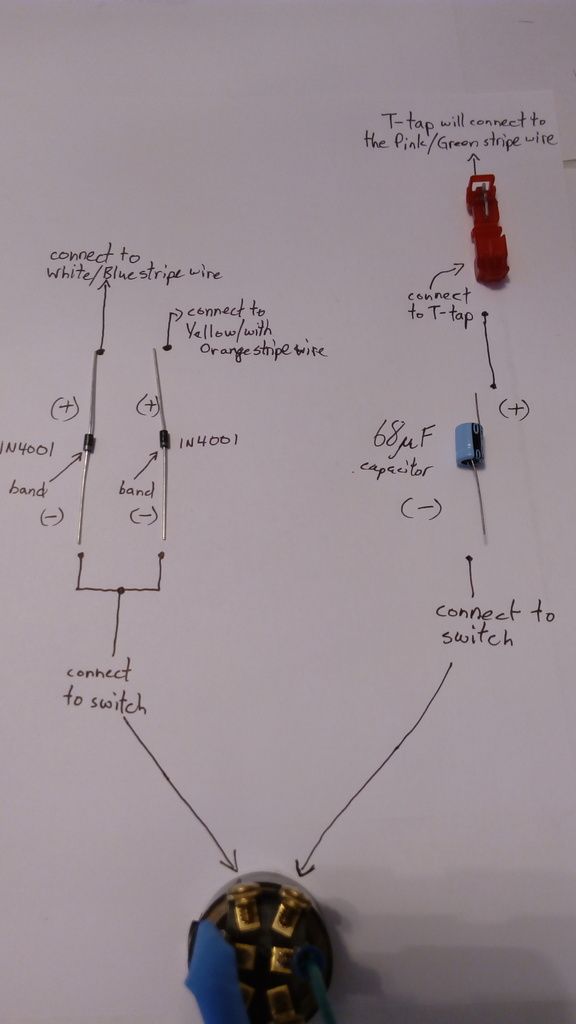

    OK grommers, this is one way of building the finbro cold start fix circuit, including the CEL on/off indicator. Pardon the crudeness, but I have no access to any illustrator software, so camera pics only.
    Please make sure the diodes and capacitor are in the correct polarity (do not reverse) or else KABOOM. It's easy to check it. Each diode will have a silver band on one end. The banded end is the negative or ground. The capacitor has a negative (-) label with a directional arrow. Follow the label to ground.
    Solder or crimp, use whatever method you prefer. I crimped all my connections to make it easier if I ever wanted to return to stock. And don't forget to add the heat shrink tubing as you make the connections.
    Special thanks to Nd4spdbh for bringing this to light.
    Parts list:
    wire stripper/crimper, 18AWG stranded wire, cutter, lighter or heat gun, heat shrink tubing (make sure it can fit over the capacitor), T-tap, various male/female connectors(spade, fork, ring, crimp), DPDT switch, electric tape, 2 X diodes (1N4001), 1 x 68uF electrolytic capacitor.
    The two middle prongs on the switch are both connected to ground.
